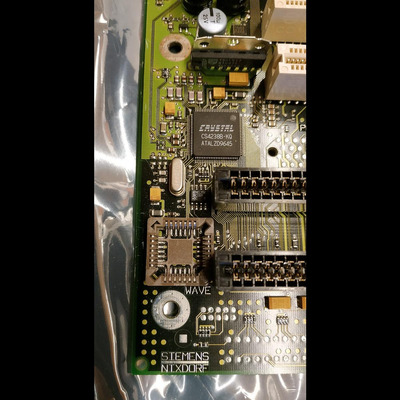

Hi,
I have a couple of Siemens Nixdorf xpert PC's. They are late 90's machine. Great allround computers with some interesting upgrade options on the motherboard. One is the ability to upgrade the onboard Matrox graphics with an aditional 2mb (through matrox memory upgrades), and the other is a Wavetable socket. I've figured out that this is for a CRYSTAL CS9236-CL PLCC28 chip. I am wondering what installing such an upgrade might do. Where would I be able to use this wavetable chip and for what. If anyone has ideas please do share.

Reply 5 of 21, by NevilClavain
It appears I have one of these crystal chips in one of my machines (I have three of these xpert towers.. love them). Do you happen to know, or have any suggestion, as to how to go about enabling it in DOS? I have to make some comparisons between this machine and the one that dors not have the chip to see if it's even recognized in windows. I'm atill having a hard time finding my way around windows 95. I've installed the driver that came on the CD for the machine, so assume it would install the appropriate windowsrelated stuff. SbPro is atomatically initialized when going into DOS mode (through cwbinit) but i am unable to use general midi as a music device.

Reply 8 of 21, by dionb
NevilClavain wrote on 2021-01-20, 23:41:
Hang on... exactly which Crystal chip?
The CS9236 is a wavetable chip, this config is for the CS4232 which is a (good) SBPro2 clone - but no built-in wavetable. If you only have the CS4232, it's behaving as designed.
Reply 9 of 21, by NevilClavain
dionb wrote on 2021-01-21, 07:54:
Yeah, the CS4232 is soldered in place. It's part of the machines soundsystem, but there is a socket for CS9236 as well that is labeled "WAVE". My assumption has been that this is a wavetable addon. Well, it's even mentioned in the system user guide under the "UPGRADES" section. Optional wavetable addon. But it does not say anything about configuring.
In windows 95 I have two midi-out options:
"MIDI for Crystal PnP System MPU-401 Compatible"
"MIDI for FM Synthesis"
Both are working but the former sounds a lot nicer. Would that be the CS9236 chip at work, and I'm just experiencing some issues with dos-mode or is this some windows MIDI-emulation device?

Reply 12 of 21, by imi
Cyberdyne wrote on 2021-01-21, 09:36:
Hold on, need pictures, it might be a VGA VESA connector. They are the same size, and many motherboards with onboard VGA have a VESA connector, but I have never heard of a motherboard with a Wavetable connector. So please be sure, not to fry your motherboard and/or wavetable card. Both have exactly 26pins.
it's a PLCC socket, not a normal wavetable header, I have one of these nice siemens boards too 😉, like this:
195.47 KiB
1057 views

I have three Siemens Nixdorf xpert computers, they have slightly different product numbers but have the same motherboard. All three machines have a socket labeled WAVE which the manual states is for "optional wavetable upgrade". You can see the socket in imi's picture. Some time ago I discovered that the chip to be used here is CS9236. I just discovered that one of my machines actually have this chip installed in that socket, so I must have purchased one and installed it. These are not different systems, they are all the same, it's just that only one of my machines have the socket populated. The .ini file that I posted was for the crystal audio driver installed on the machine that HAS the CS9236 chip in the socket. But, yes it does not appear to have anything to do with the wavetable chip (as far as I can tell), so I'm at a bit of a loss. I assume I should be able to use the wavetable functionality in both DOS and Windows, but I'm not sure how to go about getting it up and running.
Now, I have two machines without a chip in that socket and I'm trying to get one of those set up now to see if they also report the same two MIDI devices in Windows. The old IDE drives are faulty so I have to reinstall windows and install drivers etc. It appears to me that the crystal wavetable chip is working in windows95 (if that is the reported "MIDI for Crystal PnP System MPU-401 Compatible"), but when trying to use "General MIDI port 330" in DOS i get no sound, or a message saying no device found there.
However, I might be far off as I'm not really familiar with how any of this works. 😒
Reply 15 of 21, by NevilClavain
I just got one of the other machines up and running and it also has both those MIDI devices even though it does not have the chip installed. Perhaps my crystal chip is faulty, or perhaps I need some additional driver or other driver package?

Reply 18 of 21, by NevilClavain
I just got concerned that perhaps I had put the chip in the wrong orientation when I installed it. I found these:
Ebay auction of a motherboard with the chip installed
Datasheet for the chip
I did not install the chip in that orientation, but with the "bottom" of the chip facing the top of the motherboard. Upside down, in a way. But rotated to the left compared to the one in the ebay auction. Can anyone tell, based on the datasheet and imi's photo which is correct?

Reply 19 of 21, by imi
well 9 is default, so if you can't choose it should be that anyways 😒
this seems correct judging by the socket.
