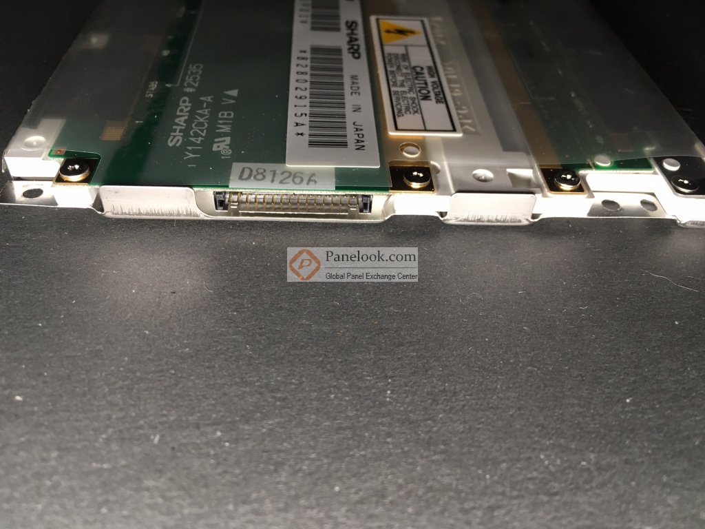

I've been looking into this myself to determine my options to fix my dud display on my 100CT
Does anyone know what the connection type is for the Sharp LQ71Y03? I've been trying to determine if I could buy a modern LCD panel and make use of the exiting connector
From the above image (which I found at https://www.panelook.com/LQ71Y03_Sharp_7.1_LC … view_10333.html) it appears to be a 16 pin connection?
Another option I have been considering is attempting to get a VGA feed from the expansion port and using that to drive a new LCD panel, like the approach used in https://www.youtube.com/watch?v=vvn2lBFhioQ
