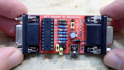

Hello there,
just wanted to briefly introduce another small project of my - a MCE-Adapter. You can use it to connect old PCs to a 15kHz capable RGB/VGA Monitor or to use it with Sync converters like GBS-8200. I made it to be able to use my Hercules, CGA and EGA graphics cards, but may be someone else will find it useful as well. The project is completely open source, both hardware and software.
Features:
- Converts digital MDA, Hercules, CGA, low-res EGA, high-res EGA to analog RGBS or RGBHV/VGA signal
- Color DAC for 3, 4, 16 and 64 color modes
- Switchable composite sync from H- and V-Sync
- Loop through HV-Sync, colors conversion only mode
- Switchable composite sync inversion
- Includes IBM's "brown-hack"for CGA and 16-colors EGA modes
- Switchable green and white monochrome screen emulation
You can find the project here:
https://github.com/necroware/mce-adapter
I also made a video series about it on my youtube channel, if you are interested:
https://www.youtube.com/watch?v=7c3yLX52ZEs&l … uGk6_uk54765G1t

How does it handle the EGA 640x350 mode? what is the output?

Hi, as I wrote it can handle hi-res 64-colors EGA. The output is always analog RGBS or RGBHV, dependent on jumpers. Just watch my video series about it, they are not too long, but you can find a lot of details there.

Reply 11 of 43, by scorp
Yes, you need GBS-8200 or similar device only, if you need to convert the frequencies. If you have a 15-25kHz capable monitor or a TV with SCART, you don't need anything else, but this adapter to get MDA,CGA,EGA onto the screen.

Reply 15 of 43, by scorp
maxtherabbit wrote on 2021-02-08, 18:18:
analog displays that will sync to 22kHz for EGA are extremely rare - tri sync arcade monitors and the original NEC multisyncs and not much else
There are at least Benq Monitors, which should support everything between 15 and 31kHz (and above). If I remember right the models were BL702, BL902 and BL912. However, I think, that the list is longer, than you think, but I can't prove it, since I have only NEC Multisync here. Which by the ways easy to get, I bought two used 1970NX for 10€ each, just couple of weeks ago.

Reply 17 of 43, by scorp
Can't tell that, but at least GBS-8200 is strictly limited to 15kHz and everything beyond that sync doesn't work. Rumors say, that this is not the limitation of the used chip, but of the software. However gbs-control tried to get to other frequencies with mediocre success, as you probably saw in my video. I didn't get into the code of gbs-controll (yet), but I hope there is more improvement possible in that direction.... Well, my adapter is quite helpful for people who have a monitor with lower sync frequency support, or a RGBS CRT, like they were used for Amiga and such things. If you just want to use any VGA monitor, you probably have to take much more money in the hand and by the MCE2VGA adapter mentioned above. However it costs 10 time more, than what I made. I guess, it depends on what you are going to do and at least for my use case it was a perfect solution. Now I can directly use MDA, Hercules, CGA and all kinds of EGA with my monitor with zero latency. Btw, the VGA to HDMI adapter, which I mentioned in my video, supports also 18kHz and above. Unfortunately, it can't handle 15kHz, but that would be too awesome....
