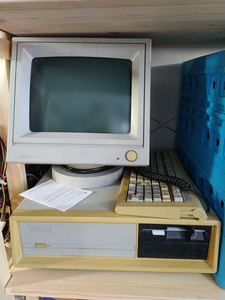

I've got this Multitech MPF-PC 552 for about 4 years now, but never got it to work as expected.
It's an IBM PC clone. It came with original Multitech keyboard and Multitech monochrome CGA screen (composite).
I think it's something special, because I have only seen exactly one more.

This computer came in as not working, plug-in cards and FDD cable were loose and the MFM cables (control and data) were missing.
365.55 KiB
356 views
(mfm controller left out here)
I have put everything together and the computer:
- gives a picture, ram is tested (motherboard, CGA card and monitor therefore work)
- the FDD is being initialized (and tested on my Philips XT computer: works fine)
- the HDD is marked as present by the controller (and tested on my Philips XT computer: works fine)

Reply 1 of 6, by weedeewee
I'm intrigued. Could you post detailed pictures of the boards, harddrive controller etc... ?
The failing to load DIOS.COM makes me think it's trying to load a ROM image from the floppy, possibly to access the hard drive .?
The keyboard problem reminds me of the Olivetti M24, which didn't like the keyb executable that was present with the normal DOS versions. You had to use the Olivetti dos version to get the keyboard to function with the correct layout. If you didn't have that... boot ok, keyboard driver load -> no keyboard.
Do not ask Why !
