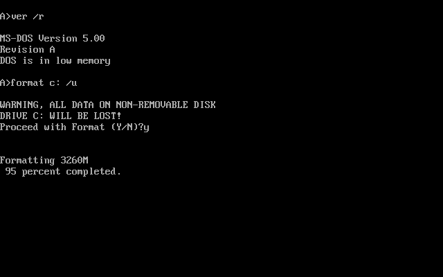

Reply 12 of 21, by Jo22
mothergoose729 wrote on 2021-02-10, 20:53:
freedos, DOS 7.1, and DOS mode in windows 9x all have fat 32 support. You can make the partitions as big as 2TB - at least theoretically.
DOS is fat 16. The 16bit address space is 2gb. One way to get around that is to make a bunch of partitions each 2gb in size. I think DOS 6.22 can address as many as four of them, or rather as much as 8 total GBs no matter how you divide them up.
    2.74 KiB
    1256 views
    DOS 5 patched

Reply 15 of 21, by Dave Bursik
There is a lot informations of about Dos 7.0 or 7.1... I gues you mean the DOS installed together with Win95 or 98.
But is anybody experienced with the clear DOS 7.1 ? I have some installation CD with DOS 7.1. You can install with it a lot of addons too. Is this version of MSDOS 100% compatibile with 6.22?
Reply 16 of 21, by Dave Bursik
Jo22 wrote on 2021-02-11, 12:39:
🙂 May I have the patch for MS-DOS 5.0?
