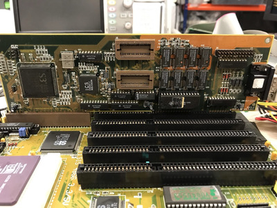

Hello all
As a "to avoid banging my head during lockdown" fun project, I sourced a faulty VLB video card. It shows the issue you can see in the video - this is the PC booting up so the flashes follow the two screens I would expect when booting up without a floppy attached. I have re-flowed all the solder joints - including the main chip, which unfortunately doesn't look in its best shape.
I was thinking of a memory corruption issue? I have replaced two of the chips but that did not fix it - I have other coming (those are JSOP directly soldered on the PCB so I'd rather not removing them again with hot air).
I was wondering if anybody had any suggestions?
As I said, this is a fun project, I totally understand that this card is not worth my time! 😀
Thank you!
https://youtu.be/eEjGfzOMXxA

What model Dell is that monitor ? Looks like it cannot sync properly, does the VGA cable have all 15 pins ?

I never had issues with that monitor and another video card works fine. This S3 was sold as "faulty" that's why I did not think too much of a monitor issue - I can try another one though. Yes, the VGA cable has all the pins. Monitor is a P2411Hb

What i've found is that the signal on those cards is very low. When i disconnected the 6 diodes near VGA connector, the picture became a lot brighter. But i have no solution for v/h sync signals. I had a LCD, that had also trouble recognizing that there is a proper picture and i blame the low signal level of v/h sync signals.
I have no oscilloscope to confirm that, but this is what i have figured out so far. Looks like the ramdac produces too low signal for some LCDs.

Also check the 14.318MHz crystal while you're at it, and maybe replace the decoupling caps with some of higher quality.

I've compared the signals. The "faulty" card is actually showing higher signals than the working one. But most importantly I can "see" the corrupted picture on the scope - it's clearly flashing stuff while the working card has a completely different signal which is consistent with the text that appears on screen.
The junk signal comes out of the DAC.
I did check the crystal and I do have the correct frequency on the DAC indeed.

For the successful operation of this video card, it is necessary to set the jumpers correctly (because they physically connect some memory lines).
Here is a description of the jumpers: https://stason.org/TULARC/pc/graphics-cards/U … VGA-S3-805.html
So, you need set JP5 1-2 and JP4 2-3.

OMG! It works!!!!
Thank you Tronix - I do not know why I didn't check the jumpers? It's usually the first thing I do when I get a "faulty" board and 50% of the times it's all it needs.
I believe I just didn't find the correct datasheet.
