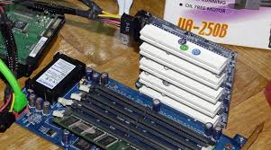

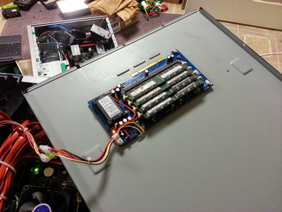

There have been a few guys that have managed to make the i-RAM drives work outside of a motherboard and I will soon have one and may want to do something similar.
while some of the solutions are easily reversible none of them seem very elegant

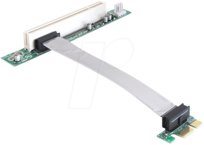

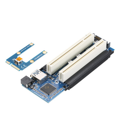

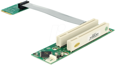

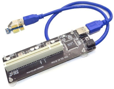

I'm thinking maybe one of those external pci express to pci boards may be what I am looking for except just without plugging the pci express part in.

here is a collection of information about other mods that people have done
http://mattaw.blogspot.com/2014/06/modding-gi … ramdisk-to.html
https://www.eevblog.com/forum/projects/pci-gi … t-the-pci-part-)/
