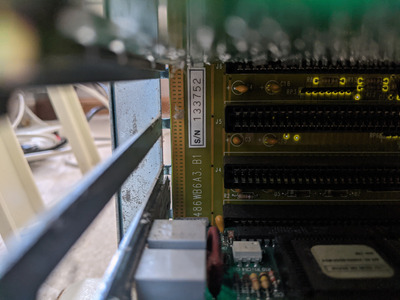

i recently came into ownership of my (dad's) intel 486dx33, 16MB FPM RAM, 64kB cache, AMI BIOS, 1MB trident VGA card, what appears to be an early-ish super-IO with a samsung chipset but is horribly damaged from battery leakage, i have no idea who manufactured the motherboard (and believe me i've looked) but it's a "486WB6A3.B1" assembled by and purchased from insight (enterprises?) circa ~1991. it suffered barrel battery leakage, of course. the obvious damage was the very top 16-bit ISA slot (literally every pin green) and the controller card that was plugged into it, and its rear ports. some timely but minor rust in case corners but nothing obviously electrically impactful.
the first time i booted it (without cleaning or testing anything because i am admittedly an idiot and that will be a recurring theme) it didn't catch fire, but it didn't do anything except a beep code which i later decoded as "no video output." disregarding a lot of triviality here but the relevant bits are: i got a POST card on which -12v (obviously bad) and +3.3v (maybe expected?) don't light up, the VGA card does in fact work but intermittently, and when it does it's so dim it's literally one shade away from "off". i picked up a CF-to-IDE adapter and gotek floppy emulator, but no IO of any kind admits to existing - i don't even have COM/LPT ports. (i have no plans on even powering on the floppies/HDDs this shipped with.)

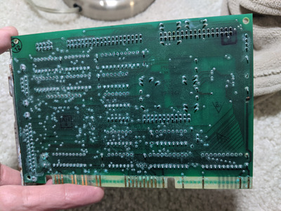

i ebay a new controller card ("w-606 super-IO", winbond W83758P + W83757AF), new VGA card (similar trident 1MB), and hell, why not a new motherboard + CPU too (seemingly identical to BEK-4801/486WB, marked "486WB4A.B1" with identical "unremovable" i486dx33 as original motherboard, 8MB FPM RAM, 64kB cache, MR BIOS, apparently crappy CHIPS chipset?) - the intent is to resurrect my (dad's) old machine, but i clearly need some kind of a test platform. the 1MB trident VGA card arrives and nothing changes at all; it's still unreadably dim when it works at all. the w-606 controller card arrives and nothing changes at all; no COM/LPT/floppy/HDD in BIOS.
the new motherboard arrives, i set up a "test" bed area on a (different) motherboard box, plug in my old VGA card, the replacement controller card, power supply, and wire up the headers. i flip the switch, my VGA card protests by way of exploding tantalum capacitor and i reply in screaming un-flip the switch as this is literally my first experience with angry vintage hardware, i'm new here. i learn that tantalums of this vintage can do that and actually spend the time to test the "new" motherboard mounted in the case, in order, with nothing plugged in, then add POST card, then with (new) VGA (obviously) and all seems well. the new VGA card is very bright and readable, but when i add the controller card none of the IO is recognized in BIOS and i assume that's probably a side effect of the VGA catastrophe.

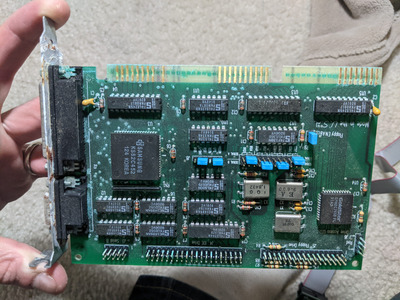

i get the morbid idea to test the old, corroded, has to be dead, literally looks gross controller card in the "new" motherboard, give it a quick once-over with 99% IPA, and am immediately greeted with 2x COM and 1x LPT address showing up in BIOS, and my feeble brain can't handle it. i decide to spend like 6 hours with vinegar and alcohol and distilled water and q-tips on the original motherboard and the surprise lazarus controller card as well. i also do some continuity testing on the motherboard where the battery leakage has done more damage than i thought, and bodge two wires onto traces that were determined faulty.
i plug the "cleaned" old controller card into the "new" motherboard, hook up the CF-to-IDE and gotek, and successfully install DOS 6.22! but for some reason edit and qbasic completely hang the machine, and looks like commander keen episode one does as well. an ancient microsoft KB 105187 suggests that the environment variable is too small, so i adjust my CF card's autoexec.bat and config.sys on a different windows 10 machine. it makes no difference.
i figure that i might as well try the original motherboard so i remount it in the case, plug in power and headers and test powering it on and receive the expected "no ega/vga" beep code, add the POST card to the realization that now both the -12v and +3.3v (?????????? undocumented -5v LED maybe?) are lighting up! plug in the VGA card, and it's bright as day! of course the w-606 controller is still unrecognized because i broke it in the explosion, right? so i plug in the lazarus controller, COM and LPT show up, disks are configurable, but i get a LOT of IO errors, particularly to C:, but to A: as well. that controller's dying. it's literally being eaten from the inside out, i'm sure of it.

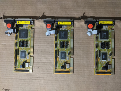

the 2 "new" w-606 controllers arrive, identical to the ebayed card except one has the silkscreen for the part on a different area of the card. for ease in identifying, the ebayed card is "QB"; the new one with the same silkscreening is "QA", and the new one with different silkscreening is "QC" because that's what the stickers say.
i begin testing the cards in the replacement motherboard with MR bios. card QB has never admitted to being a thing that exists in either motherboard. card QA causes the new motherboard to sing the beep code song LHLLH which seems to be "mainboard failure" and that's not encouraging, plus the POST codes are 0908 meaning essentially "Master 16-bit DMA controller failure" and "Memory refresh circuitry failure" respectively. replacing it with card QC causes the motherboard to... possibly POST, but i'm not sure, since the VGA card never outputs any signal? the post codes stop at 2120 which is "System key is in locked position" and "Fixed disk configuration change, diskette configuration change, serial port configuration change, parallel port configuration change, video configuration change, memory configuration change, or coprocessor configuration change" so yeah, i've gotta set some BIOS options, but my monitor is still in standby, so i have a bit of an issue with being able to do so.
i haven't tried either new controller card in the original motherboard yet; i figure there's probably no point if they don't even work in the otherwise demonstrably-working motherboard.
i've verified jumper settings as hard as i can and none of them make any difference so far. i'm seriously just completely lost. like, is it plausible that i got 3 bad cards from what turns out to be the same storefront and they all just fail completely differently? am i just missing something embarrassingly fundamental that i haven't even considered?

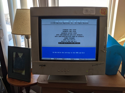

-both motherboards will let me open BIOS setup reliably, the replacement will boot off a DOS 6.22 install disk 1 image via gotek, and the original sure tries but as mentioned, it's like 10x slower even accessing the disk image, and almost never reliably boots into DOS setup

Reply 1 of 12, by Horun
Can you post a picture of the motherboards ? When I test old ISA or PCI based boards I never add any cards except a known good video card and see if it boots. You need to get a good vid card and start with that before adding any controller cards.
Reply 2 of 12, by Tiido
That board needs a lot of work before it can work properly with any card. All the corroded parts need to be removed, cleaned or replaced altogether. There's probably bad vias and other things too that must be repaired.
Some photos of both sides of the board near the battery will be helpful in figuring out what the extent of the damage is and where there may be some problems to deal with.

Also... on the 'working' setup, what are the CMOS Setup settings for the cache and RAM timing? Have you tried adding wait states to the DRAM and Cache, to see if that makes QBasic, Edit and Commander Keen behave a little better?
Better yet, can you provide a picture(s) of your CMOS Setup settings (both Advanced and Chipset Setup options, if possible)?

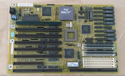

🙁 🙁 news i was prepared for, but i don't love hearing it... pics of the new board likewise attached, my apologies for leaving it mounted in the case as i'm devastatingly lazy

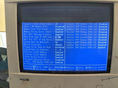

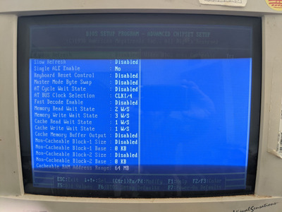

Bad RAM or power supply are also two possibilities as well.

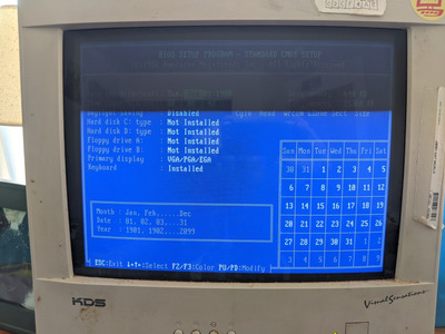

i have not actually made any adjustments to cache/DMA/shadowing/anything more substantial than disk geometry and boot order, figured i should probably have a baseline "well it runs DOS successfully" first, and that brief moment in which DOS did work (albeit with pretty obvious problems) caused me to assume that the defaults were good to go. complete and probably over-the-top album of BIOS/CMOS setup included below.

replacement motherboard: https://imgur.com/a/hPBiEGK
far too much CMOS/BIOS setup: https://imgur.com/a/ObXXYS5

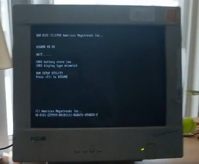

Reply 5 of 12, by Deksor
I identified your original motherboard here : http://www.win3x.org/uh19/motherboard/show/4592
Is it possible to image the BIOS please so I can add it to the page ?

The new board appears to be one of several reference designs based around the OPTi 82C493/82C392 combo. Very nice that it has MR BIOS, these usually come with AMIBIOS.
This looks like a likely candidate: https://stason.org/TULARC/pc/motherboards/Q/Q … C-486-P486.html
Under Chipset page in MR BIOS, try increasing the Read Waits and Write Waits to as high as they go, and re-test.
If it makes the system behave better, then reboot and go back into setup (Ctrl-Alt-Escape from a DOS prompt for the 'fast' way) and gradually reduce the timings until the system isn't stable anymore, and then go back and put them to the lowest value that was stable. You may wish to do the same for the Write Timing and Read Timing parameters under the Cache page.
that's unreal, i've spent hours trying to identify this board 😁
oh wow, thought i had it pegged as https://stason.org/TULARC/pc/motherboards/B/B … 4801-486WB.html but that sure looks probable...
soooooooo 2 read and 4 write waits ARE the max for those settings 😐 i didn't change the cache parameters yet, might give that a shot in a bit when i can get back to the machine... i don't suppose any of those settings would make any of the controller cards act any differently, particularly the one that simply cancels all video output when it's plugged in? i did try changing the "VACANT" entries in the shadow configuration to RW-Shadow, and noticed that C400/C800 video banks no longer say ROM #1, but also RW-Shadow and i sure don't THINK i set those ones, but i'm notorious for being incredibly wrong quite often 😀

i can at least provide the POST string:
40-0101-ZZ9999-00101111-060691-OPWBSX-F

i did try out the 2 new w-606 boards on the original motherboard just out of morbid curiosity; with the QA card installed, it fails to POST on codes 0x27 and 0x28 which doesn't seem quite as disastrous as the replacement board's "MAINBOARD FAILURE" song ... i guess? it sure isn't much better though. with the QC card, it ("expectedly") ceases to exhibit any video output, and the motherboard actually plays the 1:8 beep code for no video adapter and i don't even know how that'd happen; like how on earth would a super-IO card knock out a video adapter?
