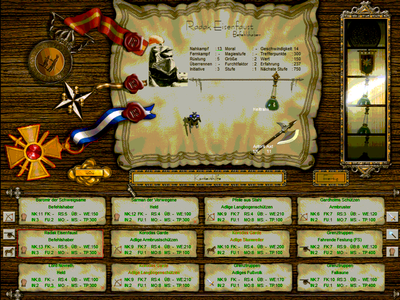

The game Demonworld II - dark armies is in and of itself rather an unknown and also rather unpopular game. But I love the game myself and would like to make it work.
So far it works great with dgVoodoo. Only during a certain mission does the game suddenly crash while it is half loaded with the message:
"DirectX Error: 2147024809
DDERR_INVALIDPARAMS
One or more of the parameters passed to the method are incorrect.
(dxDispDev -> GetDirectDraw ()) -> CreateSurface (ddsd, Ipsur, NULL) "
DirectDraw ... the error message is probably related to the DDraw.dll. But I understand practically nothing about that. I already googled the error message but couldn't find a solution. That's why I'm here now ... Help?
Without dgVoodoo, it can load the battle with no problem.
Unfortunately, it becomes unplayable during the battle itself.
I have already tried a wide variety of settings. Unfortunately without success.

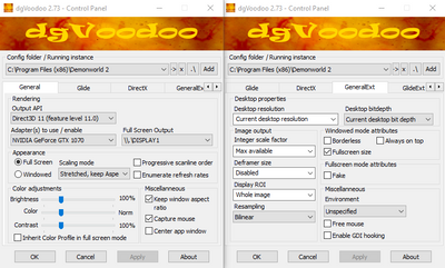

Good evening FulValBot
Thank you for your answer.
I tried these settings but unfortunately it didn't work either.

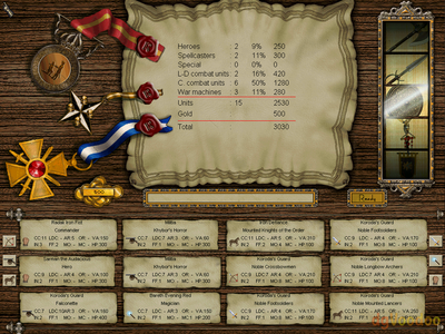

But I still have one question. For some reason the font is shown in green in some places like this:
337.01 KiB
1120 views
Should actually be completely normal in black. Do you have any idea why? It's ugly but at least the game is still playable.
And thank you again!
Reply 11 of 14, by ZellSF
The game doesn't render its own fonts, it relies on Windows to do it. It asks for a black font and relies on Windows to give it that, but fonts in newer versions of Windows are by default rendered using ClearType, which utilizes subpixel rendering: https://en.wikipedia.org/wiki/Subpixel_rendering . The font, which the game expects to be greyscale, actually uses RGB and that messes with either some sort of color keying or paletting the game uses.
Use this to disable ClearType:
https://karpolan.com/software/cleartype-switch/
I also recommend disabling font edge smoothing, it doesn't really look good on low resolutions. For desktop use you should leave both on as text looks much better with ClearType, the above utility has commandline switches so it should be easy to automate using it.
