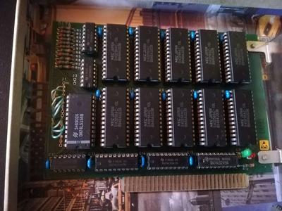

Hi, yes.
Some programs can use EMS, which makes them use less conventional memory.
Some motherboard chipsets do feature EMS, but also can repurpose the EMS page frame (the EMS "window") as a 64KB UMB.
UMBs are also available in a PC/XT system.
However, it often requires installing a physical RAM board that makes memory in the 640 to 1MB tange available.
Such a card looks like this, for example :
273.16 KiB
607 views
Source: Re: 80x86/Vxx PC emulators with x87, EMS, UMBs and no artificial 640KiB limit ?
Alternatively, you can use that 1MB card from Lo-Tech..
Last, but not least, a genuine Hercules board can be used to make 64KB available.
Edit : Umbherc.sys requirements ?
If the system uses CGA graphics only, conventional memory can be increased up to 736KB.
Often without much trickery, by the way.
That setup was quite common in the mid-80s, before EGA/VGA got in the way. 😀

Unfortunately I can't do those things as I'm not using a PC with options like add-on boards and hercules cards etc 😉
I'm using a HP 200 LX palmtop with MS-DOS 5.0 on it (although I do have a directory with most MS-DOS 6.22 executables in it)
It's got 2MB ram, 640KB conventional MS-DOS RAM, etc...
and it's got a 1.2MB ram drive.
I'm using a specific tool (a config.sys device driver) for the LX that creates expanded memory in MS-DOS,
from a data/swap file on the ramdrive of the palmtop.
I created a 1 MB data file for it and now, the output of the mem command is 640KB conventional memory with about ~580KB of it available,
and 1MB of expanded memory, ready for use.
The system has a 80186 CPU (equiv to a 8086) and uses standard CGA graphics...
Are you aware of any software tools or trickery so i can increase my conventional memory to be more than ~580, by using the expanded memory that's available ???

Hi Terrence! I see, makes sense. You can try out "The Last Byte Memory Manager".
It turns the EMS page frame into an UMB, so you can load drivers high.
Re: Headland HT12/A 286 chipset: UMB driver?
Not sure if it is compatible with your handheld, though.
I tried The Last Byte on a 286 once, but it has been a while. 😅
https://m.youtube.com/watch?v=lr9KrPNis-Q
Good luck! ^^
