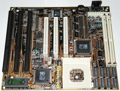

hi,
I have revision B5 for sis496/497 (motherboard is Amaquest AP8548 DX2-66)
Does this revision support EDO RAM or EDO and FPM RAM or FPM RAM only or EDO RAM only ?
Thanks for your help.

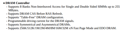

debs3759 wrote on 2021-03-04, 11:55:
Pretty sure all revisions only support FPM. I know up to B4 is said to be FPM only.
I don't know where this belief comes from...
See:
486 Green PC VESA/ISA/PCI Chipset
SiS 85C496/497
Preliminary
Rev 3.0
July 1995
The attachment 2021-03-06-181102_638x162_scrot.png is no longer available
Reply 4 of 6, by pc2005
gnif wrote on 2021-03-06, 07:13:
The original datasheet is in colors. This line about EDO DRAM is in purple. The purple colored sections are only implemented in later chipset revisions.
