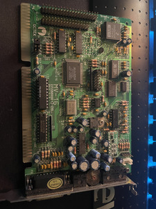

Hi, i have a Jazz16 mv16 and i have too a CDROM 8X IDE.
Can they work or are they incompatible?
I know that it works with CDROM SONY, MITSUNI or PANASONIC.
Could it work with another CDROM IDE?
Thx ☺️

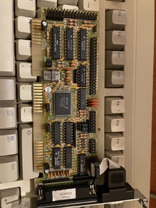

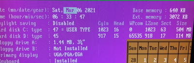

Reply 11 of 13, by GEOCE
I have two hdd and i have another controller to install, they are the same, when i install it, it gives problems. The computer is a 386SX 25Mhz.

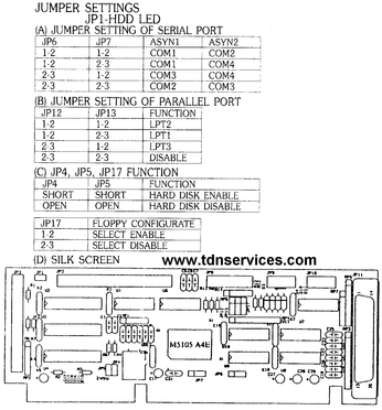

Reply 12 of 13, by weedeewee
Did you read what I wrote in an earlier comment ?
You have to be able to either disable or set to an alternate address the ports on the other controller and you will have to set the IDE controller on the other controller to the secondary IO channel.
From a quick glance at the photo, it does not seem possible with that card. Do you have a manual for it ?
edit: found what looks like the manual https://www.elhvb.com/iocard/tdnservices/m5105.gif
It is not possible to use this card as a secondary IDE controller.
    46.53 KiB
    91 views
    Multi IO card - Acer m5105
