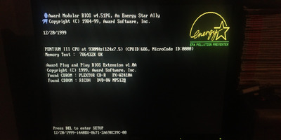

Thanks for your all replies and help. When changing FSB to 133, Bios shows speed of 00 Mhz, apparently don't recognize actual speed, but under windows everything is fine and shows speed of 1 Ghz.

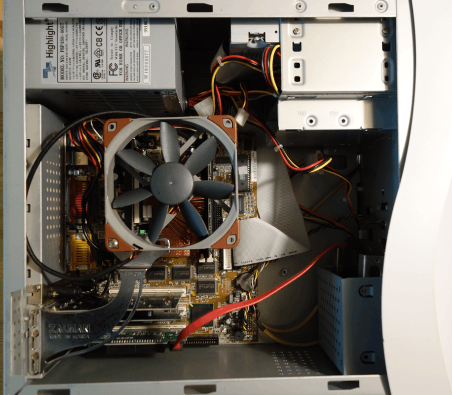

This sort of beast (shown mounted on a slocket):
Now, fully passive CPU cooling only works with sufficient airflow. OEM cases frequently have ducts for that, but with generic ATX stuff, you probably will need a case fan that blows down on it. Fortunately, Zalman supplies a bracket for exactly that, something you mount on the first three expansion slots that positions a big, slow casefan above the CPU. Of course, the default 80mm or 90mm (depending on model) fan wasn't big or slow enough for me, so I swapped it out for a 120mm Noctua Redux:
zNylMeb0tI4j0X5Alm6lHYkW.png?f=user_large
This currently keeps a P3-1400S cool without a sound. Your P3-1100 is 8W hotter, but should still be well within the limits for these heatsinks. They were designed with Athlon Thunderbird in mind, and although not the best overclocking options, they worked fine on a stock 70W Thunderbird, so 40W Coppermine should be no problem at all.

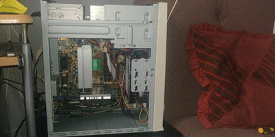

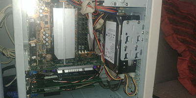

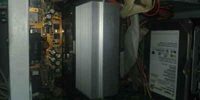

Can you post a couple of photo's of your system + interior ? Some of us are always interested in other people's builds.
Reply 12 of 20, by MB17
PARKE wrote on 2021-03-07, 17:41:
Yes, sure. Here are photos:
