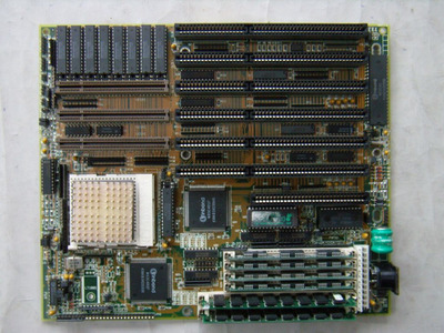

Hi!
I recently acquired two old socket 3 motherboards and decided to build a childhood 486 system around them. Unfortunately one of the boards had the known battery leak problem and the traces from the battery were completely eaten, however the board has a external battery header, at least I believe that's what it is, it has three pins and it is marked "BAT" and pin 1 is also marked, Does anyone have an idea about how the external battery should be wired? Luckily it seems that otherwise the board is working just fine. It seems to be an Abit PW4 Rev 1.0 board, I haven't found a manual for this model, the only thing I have found is the jumper configuration table and jumper layout, but the "BAT" connector isn't there.
Thank you for any advice,
Lukas.

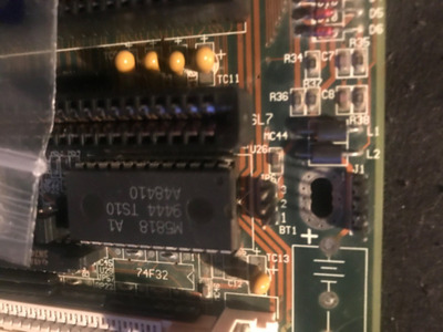

Reply 2 of 5, by anonyfous
No, it is just three pins in a row, however there is a four pin header "J1" right next to it. I will chech the ground pin with multimeter, but I still need to figure out the positive pin, I guess it is not a good idea to apply voltage to some random pins. Yep, I have already cleaned the board with vinegar, then rinsed it with water and dried with a fan. Fortunately the damage wasn't that bad, basically just the traces from the battery it self and a bit of the power rails, but nothing really serious. I was able to boot win 3.11 just fine.

Reply 3 of 5, by weedeewee
from the TH99 info J1 is the battery connector. probably pin 1 Vbat, pin 4 Gnd, though that's just a guess. better measure for certainty. Vbat will likely go to a diode. enjoy.
