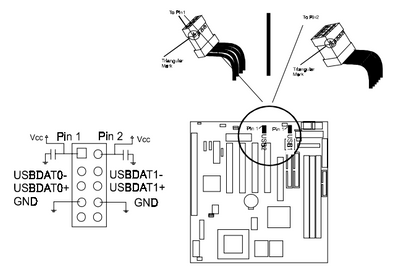

Greetings. Im trying to add usb support on a FIC va-503+ board. i even got the manual and in it..there is a low quality picture of an optional USB board that connects to the motherboard.
( it does not look like a simple cable, this usb addon board looks like it has some components in it besides usb ports i see some capacitors and other electronic components) I tried searching on google for such addon and found nothing. I even found pics of the box, cd, and bags that this board included in the box and i did not see this usb addon card in the box.
So i came here to find out if anyone here has such addon, or how did you solve the problem to add usb support to this motherboard. If you bought another card or if you bought a PCI USB (would like to know which model and brand/chip maker did you buy)
usb is very important for me, specially for win98 so i can transfer files.
thanks
Reply 2 of 21, by Repo Man11
There is a header on the board that you can attach a USB cable to - the only difficult part is finding out the pin out of the header so you can match the cable. The VA-503+ does work with the plus series CPUs, though not officially, they are only supported by a beta BIOS, but that's more than good enough.

Reply 5 of 21, by Repo Man11
The pin out probably matches the two five pin arrangement shown here, but you need to verify that before attaching the cable, either by a manual, or with a voltmeter.
https://www.frontx.com/cpx108_2.html
To rearrange the pins: https://www.frontx.com/head_con.html
Reply 6 of 21, by Thermalwrong
I've got the FIC VA-503A board, it shows the pinout in the manual, it is just a regular USB port backplate cable:

Reply 7 of 21, by EPoX
thank you very much, so its not rocket science, i can plug one of those brackets that came with many athlon xp motherboards and it will work just fine. i just need to be carefull and check the pinout with a multimeter.
that is great news
Reply 8 of 21, by peg
i have the exact same motherboard and I used this: https://www.ebay.com/itm/2-Port-USB-2-0-Hub-t … -0/323846426571
The only issue with using newer usb brackets is that there are made for 9 pin keyed usb connectors. The FIC motherboard isn't keyed so you need something like what I linked above.

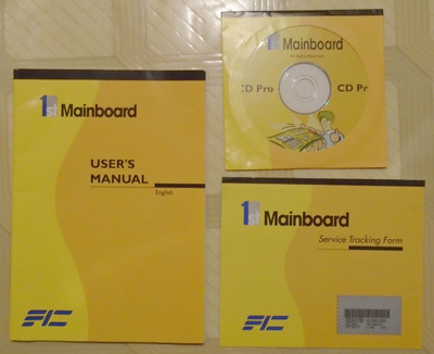

Reply 11 of 21, by PC Hoarder Patrol
You mean this 😀
296.78 KiB
363 views
Can't imagine its particularly rare (or valuable) - happy to write you an ISO

Reply 13 of 21, by PC Hoarder Patrol
Yes, these are from my retail boxed version of the VA-503+ (PCB 1.2A), bought new in 2000-2001
1009.86 KiB
314 views
I'll get the ISO written / uploaded over the weekend and link it here.
