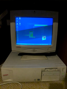

First post, by LewisRaz
I have had this P2 deskpro in storage for some time until recently I found out the storage area had a massive damp problem so begun to rescue my PCs from there....
Anyway this beauty was part of what was stored there and after being kept warm and dry for a couple of days made a big flashy boom as soon as power was sent to the PSU.
From what I can remember it uses a proprietary power connector for the PSU so I cannot simply replace it.
Is there any sort of adapter or easy fix or is this lovely specimen doomed to scrap?
The monitor from this pic has also died (lets of massive random *clicks* and the screen sortof resets along with them)

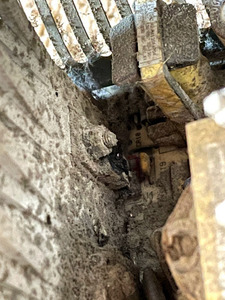

Reply 1 of 6, by LewisRaz
Just found a large amount of them online for less than £10 delivered(after searching the spares part number!)... Seems a no brainer!
I just cracked the PSU open to have a look and could not believe the dust.. I spotted the blown component.
Hopefully it was something in the PSU that cause the pop and the new one doesnt just pop as well.

Reply 2 of 6, by froller
LewisRaz wrote on 2021-03-22, 17:09:
Looks like high voltage diodes decided to do some fireworks.
Remove remains, check for short circuit behind them, solder in new ones. Looks pretty simple.
...and clear all that dusty crap out. This is one of the reason why PSUs die.

Reply 3 of 6, by weedeewee
Wait! Oh that's the inside of the PSU. I thought you accidentally posted a photograph of your cellar. 😁

Reply 4 of 6, by mkarcher
Moist dust is slightly conductive. The high voltage area of the supply has traces with 300V between them separated by just a couple of millimeters. If the dust between two pins of neighbouring componets enables a spark to jump over, it might very well blow the supply. I guess that's what happened here. Check the replacement supply before you connect it to AC voltage, and if it looks similar, clean it before you connect it.
Reply 5 of 6, by Pierre32
Yikes, a very good advertisement for inspecting PSU internals before applying juice! Hope you get it sorted.
