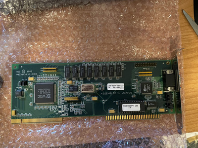

Hello all,
Recently, I purchased this STB Powergraph C33. It's in fairly decent shape, and, after properly setting jumpers W1 and W2, the card worked a-okay in my 486. I tried to set it at 0WS, and it worked there too, but I set it back to factory while benchmarking.
After that, I was using the Philscomputerlab DOS benchmark pack and accidentally ran MTRRLBFE, and the card started to act quite strange. For example, DOS text would randomly get dim, then bright, then fade. I checked the connections, tried another VGA cable, and nothing worked. I even tried the card in another VLB board and came across the same issue.
Now, when I start a PC with it installed, I get a signal to my monitor, but no picture at all. After testing some more, I'm convinced there's something up with the VGA BIOS, but I'm not certain about that. The only reason I suspect as such was that the card was absolutely working prior to running MTRRLBFE, and--occasionally--text will show up on the screen.
I've tried everything--re-seating jumpers, re-seating the card, different VGA cables, a different monitor. Is there anything I'm missing? I dumped my BIOS, and noticed something odd. The BIOS on the VGAMUSEUM seems to be 64k, while mine is 32k. Can anyone confirm that 32k is proper?
Either way, I ordered some Winbond W27E257 EEPROMs, and I'm going to try to burn a new ROM, just to humor myself. On that note, to any of you who have one of these cards, would you mind sharing a copy of your BIOS?
Attached are a copy of my BIOS and the one from VGAMUSEUM. Mine is labeled STBPowerGraphC33 and the one from the site is WD90C33-ZZ.
I'd love to hear any thoughts that any of you may have, and any help would be vastly appreciated. When this card was working, it was quite fast--almost as fast as my ARK1000VL! It's a pretty weird card, that's for sure.

Reply 1 of 24, by weedeewee
your bios size seems correct, the 64k is just 32k & padding
edit : there's also only three bytes difference between your bios and the other one.

Reply 4 of 24, by weedeewee
WJG6260 wrote on 2021-03-23, 20:02:
This may be a very amateurish question, but is it possible to burn that 64k BIOS to a 32kx8 EEPROM?
Yes. I guess easiest would be to just edit the file down to 32768 bytes, open in hexeditor, delete all the 0xFF padding, save, program.
or if your eeprom reader/programmer supports it, just write the first 32768 bytes from the file to the chip.
Also, intermittent... might be a cold/loose solder joint on the main chip due to flexing... Just a guess.

Reply 6 of 24, by snufkin
May be an issue with the RAMDAC? Sounds a bit analogue-y. If something went wrong with the Vref (pin 31 on the ATT20C491, from a quick search, near R61 in the photo) for the DACs that might bring down RGB all together so look like a fade out?

Reply 16 of 24, by snufkin
Hope the work with the BIOS does fix it. If not, do you have a multimeter? I'm guessing a lot here, but it looks like pin 32 (pin 1 is the one marked on the slikscreen by R63, count anti-clockwise from there) should connect to C51, which goes to ground. Check that there's some resistance across C51, just in case something's gone short and is pulling Vref down. Also check the resistance of R69. It looks like that might connect to pin 28, which is Rset and also controls the DAC gain. The datasheet for the ATT20C490 (looks to be similar) recommends 147ohm. If I read the datasheet correctly, if that resistor goes open circuit then the gain will go to zero.
It might also be worthwhile trying to measure the voltage on pin 32 with the card powered up. I think it should be around 1.2V from an internal regulator. There's a bit more risk poking around live boards.
I've never tried baking in an oven. I'd guess most ovens would struggle to get hot quickly enough to reflow the solder without having the board too hot for too long. Plus it might singe the labels. I'd just touch a soldering iron on any suspect joints, with a bit of flux. If it is a cracked joint then it might help just prodding at components round that area whilst watching to see if anything flickers on the screen.

Also, @all—interesting developments during my further tinkering.
Full disclosure: the motherboard on which I’m using this is an Alaris Cougar. I tried a Boca SuperX VGA Cirrus GD5426 VLB video card that I have, and I had a similar issue—no image, but VGA signal detected by the monitor. I know that card works (it was new old stock when I bought it, and I still occasionally use it, but it’s mostly kept in bubble wrap in a box), so I pulled it, moved the CPU speed jumper to >33MHz (even though the Cougar is running the BL3 at 25MHz X 3), and the card worked absolutely fine. I know the ARK1000VL is more tolerant of 0WS setups, so I figured maybe there’s something else at play?
I know the Cougar is fine and it works perfectly, but it is a really quirky board. That being said, I am not so sure it’s the motherboard because I moved the Powergraph C33 into my other 486, which runs an MTech R407e. That board works great and has no weird quirks, really, and it likes the SuperX and the ARK1000VL just fine. It, however, does NOT work with the Powergraph C33.
Further, I’m a bit conflicted because the Powergraph WAS working when I first got it, before messing with it and running MTRRLBFE.
That being said, I tried the Powergraph one more time in the Cougar, and I got an image for a SPLIT second, and then it disappeared again. I rebooted, and the image stayed longer, but faded post-boot. The Boca and ARK1000VL work fine, and even the ATI MACH32 from my MTech 407e system worked.
