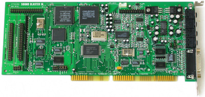

I'm trying to set up a non-PnP ISA CT2230 board under Solaris 8. All the jumpers are in their default positions (IRQ 5, IO address 0x220, 8-bit DMA channel 1, 16-bit DMA channel 5):
539.17 KiB
651 views
Creative Sound Blaster 16 (CT2230)
The sound card proved 100% operational and capable of playing 16-bit PCM samples under a modern Linux as well as Windows 2000 (I had to previously dedicate IRQ5 to Legacy ISA in BIOS, which is Award 6.00PG).
Technically, Solaris 8 supports Sound Blaster 16 and clones using the sbpro driver:
The Device Configuration Assistant (DCA), which is effectively the DOS kernel running in real-mode, mis-detected my board as "ADS Sound Blaster" (Analog Devices ADS7180), most probably because the card is non-PnP, and ADS7180 is just the 1st matching line in /boot/solaris/devicedb/master:
ADS7180 sbpro oth all sbpro.bef "ADS Sound Blaster"

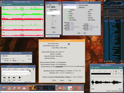

I ended up buying an AWE64 (CT4380) card, it got successfully detected by Solaris and turned out capable of playing 16-bit sounds.
So I can consider my Solaris/x86 build complete.
    677.58 KiB
    480 views
    Solaris CDE desktop

Reply 1 of 6, by Tiido
This SB16 and all other non-PnP ones have their IRQ and DMA set by software, and your driver must specifically be able to do it.
Ok, so the only thing you can actually set for the sound part side of that card is the base IO, which tends not to be a problem.
https://stason.org/TULARC/pc/sound-cards-mult … R-16-MCD-A.html
reg: 00000001.00000220.00000014.00000001.00000388.00000004.00000001.00000330.00000002
unit-address: '1,220'
This line doesn't inspire confidence about the exact IRQ and DMA being used by the driver.
I read this as it using
one of the IDE IRQ's (14 or 15) and possibly dma 1 for the base IO at 220,
IRQ 4 for the FM synth at IO 388 and
IRQ 2 for the MPU part which is located at IO 330

In fact, this SB16 has its IRQ initially assigned by BIOS, and I'm about to try and change the value from 5 to 2, 7 or 10, all of which are supported values, according to Sun Microsystems.
I can also change the audio I/O address to 0x240, 0x260, 0x280 using jumpers.
If I'm not lucky with this board -- I have a PnP AWE64 (CT4380) which arrived just today. This latter card should work just fine.
