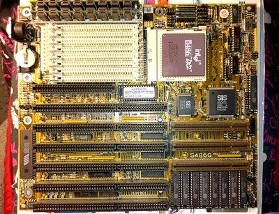

Okay, so I'm doing a bit of diagnostics on my Iston Computer Corp. S486G motherboard. I'm pretty sure this is some sort of OEM type board, but who knows. Hard to find any info about it other than the basic jumper info etc.
I've tried a couple of different cache configurations, 256KB and 512KB, different chips, different tag rams. The board reports the correct amount of cache during boot, but according to Dr. Hard, Speedsys, Cachechk etc, there's no L2 cache installed. I've tried setting it to enabled, disabled and both write-back and write-thru in BIOS, and it doesn't matter. It doesn't want to work. I know the cache chips are good from having tested them in other boards.
I've got a PC Analyzer board, and at one point during POST, it displays the code "05", which isn't listed in the manual for the PC Analyzer board, but according to a website of AMI Winbios post codes, it's supposed to mean "Disable cache". But why on earth would it disable cache when it's enabled in BIOS?
I'm pretty much stuck. Anyone got any good suggestions?

Just a guess, maybe it's one of those original fake cache 486 boards with a modified bios ?
Do you have another bios for it ?
Can we have a photo of the board?

There is probably a jumper block that configures amount of cache on your board and yours is configured for 0KB.
I can't find any information on your motherboard, your best bet is to find the pinout for the chipset and figure out which pins handle cache amount settings, then do continuity checks until you find the jumpers. Then you experiment.

Right. To rule out possibilities, I decided to test another CPU in the board. I'd tested with two i486 DX2/66 CPU's. It's my go to "safe" option. I swapped to an Am5x86, and while changing the jumpers around, I found an undocumented jumper... JP30, which had pins 1 and 2 shorted. Since there's no mention of this in the manual, I decided to remove it, and after booting the board up, I popped into Speedsys, and voila... working L2 cache. So I guess JP30 bypasses cache for some reason.

The jumpers for cache amount was set correctly. Seems there was an additional jumper to bypass cache for some reason.

JP30 is part of the cache amount jumper I mentioned above then. Using JP30 and the other blocks cache can probably be set to 0, 128, 256 and possibly 512 depending on which pins are open/closed.

Reply 10 of 37, by LunarG
Oh, forgot to post a picture of the board as requested.
    657.59 KiB
    1802 views

The plot thickens. It occurred to me that I hadn't actually tried booting with the AMD 5x86 and a jumper in place on JP30 pins 1 and 2. So I did that now, and it's still got functioning cache. So who the heck knows why it's not working for the DX2 then. *shrug*

It's probably not properly configured to operate with a DX2
Can you please send a photo that is not 8bpp and also a picture of the POST string (or preferably a BIOS dump using this http://cd.textfiles.com/microhaus/mhblackbox3 … MORY/GETROM.ZIP) so we can try to identify it and add this to UH19 ?

The original picture wasn't 8bpp. It seems to have been converted when uploading to the forum. Perhaps due to size limitations? Dunno.
Try this link: https://drive.google.com/file/d/1YvBHykpcvYC1 … iew?usp=sharing
According to the manual, it was set up correctly for DX2. But the manual may be for a different revision board. As mentioned, it's not the most high profile motherboard, and so information has been sparse. When I change settings for these old boards, I draw out my own jumper diagrams, fill them in according to the manual, and double check both my diagram before changing any of the jumpers, and on the board after changing. However, there are several types of Intel DX2 listed in the manual. There is the standard i486DX/DX2, the P24D, the P24S or"SL-Enhanced 486 DX2." Information on identifying each individual model that is available online is incomplete, so sometimes one has to resort to guesswork, or simply choose one. Now that I've at least been able to confirm that there's working cache, I will spend some time over the weekend trying to see if I can get it working properly with the DX2's as well, although it's not that important, as I'm more than happy to do all future benchmarking with the AMD 5x86.
UPDATE: Right. My DX2's are both the "SL-Enhanced" version with power management features. Gives me something to work with. I'll do a BIOS dump tomorrow and I'll take a picture of the POST string. It's getting late 😀

One thing I'm wondering about is : what if the problem with cache was not L2 cache but L1 cache actually ? The 5x86 supports both Write-Through and Write-Back cache. But That DX2 might only support Write-Through ? Causing the board to fail to POST 😀
Thanks for the photo, we'll add this board soon. A BIOS dump is welcome as well :p

I mean, the system did boot, and it ran fine, and Cachechk reported that the L1 cache was working, but that there was only L1 cache in the system. I've done all I can be arsed today.
The board has a pretty nice layout and it's actually got better jumper layout than at least one of my other boards, so it's good to see it working properly(ish) with the AMD 5x86. The manual doesn't have any jumper settings for running 133MHz unfortunately.
