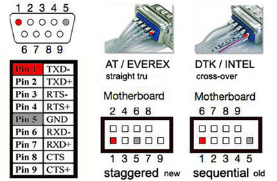

Does anyone know the pinout for the MS adapter? Is there any simple way of me testing that the COM ports work on this motherboard?

Yeah, checking the motherboard pinout is a good idea. Plus, I came across an interesting file within the files downloadable from https://www.elhvb.com/webhq/models/486pci/m919v1.htm about the M919.
The "help-vip.htm" has a description of the motherboard having problems with both COM ports and the FDC, apparently fixable by removing a capacitor on the board (I think COM ports are supposed to have a maximum slew rate and maybe it was somehow slowing down transitions too much).
