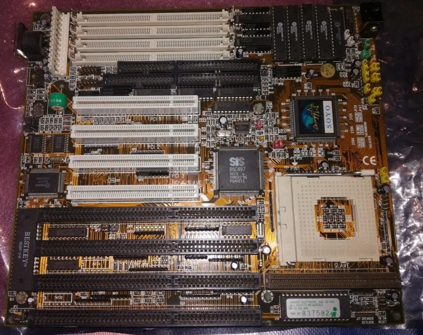

someone offered me this motherboard
battery is in great condition, but before selling.. he wanted to test it , when he turned it on, the got a "bios ROM checksum error" "detecting floppy drive A media" "insert system disk and press enter"
does this error mean the bios should be reflashed?
this is the picture of the board. but there are no markings as of what model this board is, how do you know if its a 4SAW or a 4SAW2 or a 4SAW5 ?

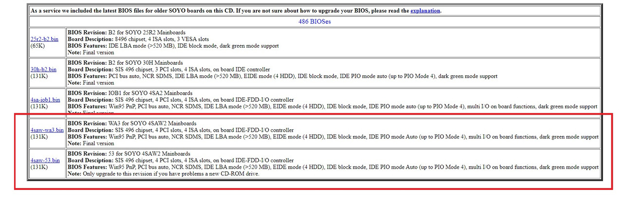

also on vogons drivers there is a pack of bios for this board, but its not clear since
-one bios says : wa3 for 4saw2 ?
-another bios says : 53 for 4saw2 ?
-there is no bios for 4saw and no bios for 4saw5.
