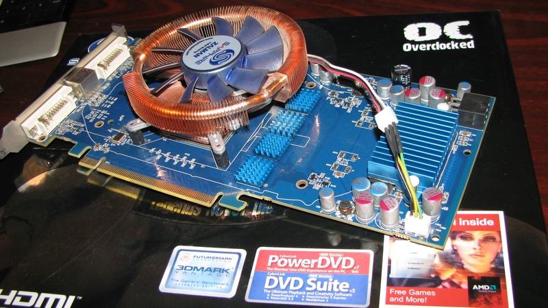

Reply 3 of 4, by RandomStranger
I think a Zalman VF700 AL/CU should be enough. You can get them fairly cheaply with Geforce 9600GT, 8600GT, GT240, HD4670, HD5670.
Gigabyte really liked that cooler and shipped a lot of budget gamer cards with it in the 65-100W TDP range from around 2005 to 2011.
It fits my FX-5700.
Details
68463-9600gt-green-gigabyte.jpgsapphire-hd4850-toxic-slika-10685406.jpg4670CardF-big.jpg
Maybe if you look for Sapphire cards, you can find a Zalman VF900 or Arctic Cooling Accelero L2. Those were shipped on HD4600, HD4700, HD4800, HD5500 and HD5600 series graphics cards.
