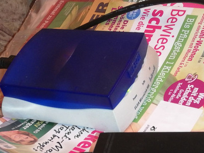

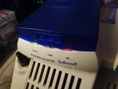

Hi guys, I have got an Elsa Mikrolink 56k modem laying around that I found a few days ago in the garage.
I'll try the command out this evening! :)
Edit: Everything is ready, but I can't find the serial cable! xD
Edit: Found the cable. Photos added.

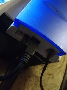

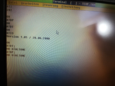

I've taken two picture with an "Elsa Microlink 56k internet".
For a real test, though, some sort of land-line is required.
Because, the modem complaints with a "NO DIALTONE", as the3dfxdude expected.
It doesn't have to be the real thing.
Some sort of VoIP router/modem with a TAE or RJ11 port will also do.
Or a classic, analogue telephone system will also do (say, an Auerswald).
Edit: Just did a test with an AVM Fritzbox ADSL router..
Entering ATDP; or ATDT; results in an "OK". The modem picks up the line (dial tone can be heard) and waits for approximately 20 seconds.
After this, it hangs up and gives a "NO CARRIER" message.
Edit: Typo fixed. I meant "dial tone", of course. My bad, I'm no native speaker. 😅

OK. So "OK" is the correct response (as Dosbox and UniPCemu now do). NO DIALTONE also can happen, but probably only when there isn't any phone line connected?
Although the latter would only occur in an emulated environment when no network card to use is present to use?
Is that correct?

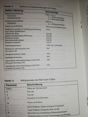

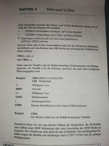

Hi there. This is a bit off-topic perhaps, but I just got an old Creatix modem in the mail from eBay.
I learned, that it supports an older standard, V.25bis. It's an old ITU standard less known in the states, for examples.
https://www.pcmag.com/encyclopedia/term/v25bis
Anyway, I thought this information might be interesting to share.
Edit: I've attached photos of the command set from the manual.
It's possible to switch between Hayes AT and V.25bis from either mode.
