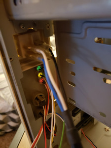

I purchased a 486 from someone awhile back, and tried to boot it up; nothing happened. I've had some free time lately, so I tore down the machine to the motherboard and want to boot it up outside of the case as simply as possible just to rule out what's happening. Having never built a 486 I'm confused by where case wires go, and what is needed to do a minimal hardware boot. I tried my hardest to identify the motherboard following some methods here (to find a manual) and this was the closest match I could find: https://th99.bl4ckb0x.de/m/U-Z/35297.htm. I should mention there was a power button on the case but it appears that there's actually no wires coming from it on the inside (you'll be able to see this in the attached photos). Thanks for all the help, all of this is alien to me! Was far too young to have ever had or touched a machine this old. Though I want to preserve it.

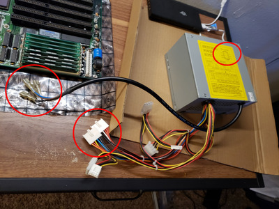

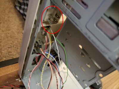

Reply 1 of 19, by DeggMan

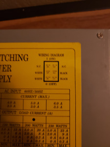

just realized the thick black cable coming from the power supply has spots for the power switch on the case.
Reply 2 of 19, by Ydee

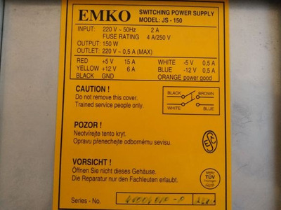

Hi, You need connect the switch ON/OFF - 4 wires from PSU (black, white, brown and blue with Fastons). The colors of the wires on each contact are described on the label on the PSU, usually is black and white wire hot and neutral from the AC line in jack on the back of the power supply. Brown and blue should be hot and neutral on the AC out receptacle on the back of the power supply, but check it on the label.
Connect the board power supply so that the black wires of the two connectors are together in the middle. If the power supply is correct, when the switch is pressed, the board should be powered up and start starting. Try boot in minimal configuration, i.e. board+CPU+RAM+VGA and see, what happens.

If you have never used an AT power supply before be very careful - there are two things to be wary of:
1. Mains level voltage (be that 100/110v or 220/230v wherever you are based) flows through that front panel switch - be damn sure you don't touch it or play around with it while the PSU is connected to the outlet. It's not like ATX where you have a low voltage 'power on' signal.
2. The two connections to the motherboard - P8 and P9 can be plugged in the opposite way around and it WILL destroy your motherboard. The mnemonic to remember is "Black to black is good. Red to red you're dead".
ATX solved these problems by using keyed connectors that could only be inserted one way and by using the low voltage power on signal to the front panel, rathe than mains voltage.

Reply 6 of 19, by DeggMan
I've attached an image of how I have the wires hooked up to the power button. Let me know if those wires appear to be on the right way. Also, a better image of the power supply diagram.
Reply 7 of 19, by Ydee
Oh, the wiring scheme on the label is for power wires only. You have a more accurate schematic on the attached photo.
It's plugged in well - black is always under voltage if the power supply is plugged into a socket. By turning on the switch, the voltage passes through to the brown wire. Black and brown are working phases, so they have to be underneath each other. If the computer switches on at the OFF switch, flip the black and white down and the brown with the blue up.
Reply 8 of 19, by DeggMan
Good news it boots. Here's this bios string I believe: 40-0400-006257-00101111-080893-U4800VLX-P. I'll have to get an adapter or appropriate keyboard before I can carry on further. It was American Megatrends bios of course.
