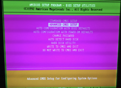

Reply 9 of 24, by Intel486dx33
The bios I have has no adjustable cache timing setting.
So I assume I am stuck with the default cache timing setting.
Reply 11 of 24, by Intel486dx33
BioS screen shots:
Reply 12 of 24, by BigDaddyM
I this is "DRAM Wait State Selection" option
Reply 13 of 24, by megatron-uk
BigDaddyM wrote on 2021-06-09, 21:18:
No, that's wait states for main memory. Which should be 0 if the system is stable at that setting.
Theres no cache tuning options on that page; only enable/disable.
Therefore the OP can't tweak the speed and therefore he'll get no advantage of faster SRAM chips.
