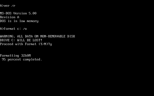

Reply 7 of 12, by Jo22
Caluser2000 wrote on 2021-06-15, 04:20:
Jo22 wrote on 2021-06-15, 03:41:
Well.. Technically, MS-DOS 5 and 6.x can support up to ~4GB per partition, but..
No they can't. NT based windows can though.
Where in the Flying Spaghetti Monsters name do you get this stuff from?
You're predictable, sir. I had the feeling that you're lurking around.
There's a patch for MS-DOS 5 that breaks the 1024 cylinder limit.
It depends on the BIOS being honest/compatible (12-Bit cylinder numbers via int13h).
Bonus point for paying homage to the great Flying Spagehetti Monster, though! 😎 👍
I, myself, are a believer, too. Also, let's hallow the Great Pumpkin! _/\○_

Reply 9 of 12, by Jo22
Caluser2000 wrote on 2021-06-15, 04:50:
So there's a patch blahblah.
Just kidding really. That is cool. So you create the partiiton using the default fdisk?
Yes, the patch works with the FDISK of MS-DOS 5.
I tested it a few years ago in Virtual PC 2007.

Reply 12 of 12, by Jo22
debs3759 wrote on 2021-06-15, 05:54:
Jo22 wrote on 2021-06-15, 04:45:
You're predictable, sir. I had the feeling that you're lurking around. […]
A 3rd party patch making it possible is not the same as the OS technically supporting anything. The OS may recognise larger partitions after they have been patched (same as 2m30 allows the OS to read 3.5" floppies up to 1.78 MB or larger) but without it, DOS can't create or see them.
I've downloaded the patch to look at later. Shame it doesn't include source code 😀
Hi! Please take some time later on and read the documentation! 😀
To quote the author "Since DOS is so very close to supporting really large disks anyway,
I found it possible to patch the DOS disk device driver and eliminate the 1024-cylinder maximum."
That patch is more of a "fix" than the usual patch.
It makes DOS retrieve the drive geometry in a slightly different way and
another, optional utility then changes the state of cylinder 1023 (diagnostic cylinder).
It's MS-DOS 5 itself who's happily supporting ~4GB partitions after changing a few bytes.
With a little bit of thinkering, MS-DOS 6.22 could be made to handle this, too.
The "problem" is, that the utilities are from the early 90s and are hard-coded for English MS-DOS 5.0 (not 5.0a).
Or in other words, they don't know DOS 5.0a/6.x. Thus, they don't know the locations that must be changed in the binary files.
