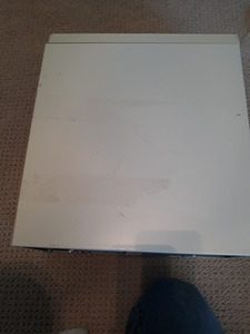

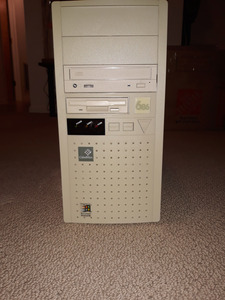

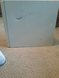

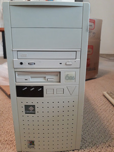

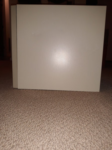

Last but not least, the case:
https://www.ebay.com/itm/254890056544
I had a really hard time finding a good one. After several days of searching I came upon this system. I really liked it, but it was priced a bit out of my remaining budget. I really just wanted the case and psu. I sent an offer in that was probably too low and got rejected immediately. I kept looking for a few more days and nothing came up. I sent the seller a message asking if he'd just part it out as a case and psu... No luck. I sent a revised offer and let him know my interest. I told him about my budget and asked him to send me a counter offer or let me know if we were just too far apart. He accepted the offer later that day. I'm really happy with the case. It really screams 90's to me even down to the name (cybermax). It's probably a bit older than the rest of the build, but I think it fits perfectly. I have some extra parts now though that I have no idea what to do with. 🤣
I decided to wait on the network card for now as well. I need to research it more. I'm not really sure what all you can do with them or if it would really have much use. I'll probablly look into getting a usb port for thumb drives and stuff. I think it has to be USB 1.1 for Windows 95... Anyhow, that's about it. Anything I forgot or anything else that would be cool to add?

It's a good looking case and seems to have some interesting hardware of its own.
The Cyrix 6x86 120 would suggest a socket 7 motherboard and the soundcard looks to be a Ensoniq Vivo, Not a very popular card but interesting from a technical point of view.

Reply 12 of 18, by LUCASX95
Update!
The case arrived today. As of right now I'm only waiting on the mouse. It survived shipping and looks even better in person than in the listing. I got to cleaning it right away. I started off using some windex to clean off the light dirt. Aside from the black marks, (pictures attached below) it really wasn't that dirty. The windex unsurprisingly didn't get much off. Next, I broke out the Mr. Clean Magic eraser. After investing a good amount of time and elbow grease, pretty much all the black marks came off. The last thing I attended to was some tape residue. The case arrived with a few strips of clear shipping tape one it. I peeled them off right away. I used some Goo Gone and did a bit of scrubbing and removed 95% of the residue. There's still a bit stubbornly hanging on. I may go back and tackle it later. Overall I'm really happy with how it turned out. The before and after pictures are attached below. I appologize for the lighting in the after pictures. It was much later in the day and I end up using the flash on my camera to help illuminate them a bit better.
Looking at everything I think this might be all original. The case is badged for a Cyrix 6x86, and the CD drive looks like it was made for it ( it probably was). I almost don't want to take it out because it fits the case so perfectly. I just assumed it was a socket 7 anyways.
