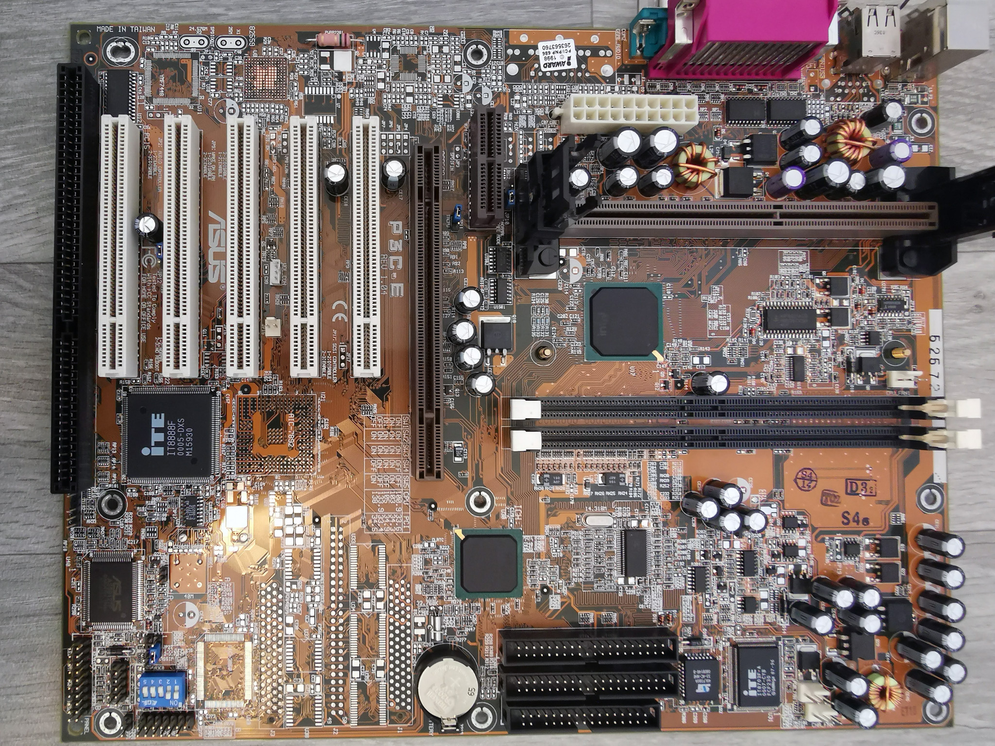

I've recently come into possession of an Asus P3C-E that appears to be stone dead 🙁
Currently loaded up with 256MB of PC800 (2x 128MB sticks), and a P3-733 133FSB Slot-1 CPU. I've tried numerous video cards, but I'm 100% sure that the motherboard itself is the problem.
When powering up the board, my POST test card shows "----" (so totally brain dead). Messing with the CLRRTC or the CMOS battery sometimes make the POST test card show C0--, but more often than not, nada.
I've tried another CPU (P3 500, 100fsb) and as I say, various video cards. Booting without RAM makes no difference to the output. I unfortunately don't have a RIMM terminator to try single sticks, but I'm not sure it would make a difference. The RIMMs are known good.
I've tried both jumper and jumperless configuration for clock speed, as well as "safe" mode and normal mode. FWIW, the board appears to be some kind of OEM version as it has a "VPANEL" header that doesn't show in the Asus manual for the board.
On a wild hunch, I desoldered the BIOS chip and tried to read it with my minipro, but kept getting pin detect errors, so possibly a dead BIOS chip. Replaced with a known good SST 49LF004 and a freshly flashed latest BIOS, the board still shows "----" on the POST test card.
At this point I'm all but resigned to tossing it in the eWaste, but thought I'd throw it out there for anything I may not have thought of.

Reply 7 of 13, by paradigital
This is the board in question:
And here's a link to a Google Photos album for the board with close ups of all areas of the board front and back:
https://photos.app.goo.gl/xrRvNnd5zpt2K1dU8
Reply 8 of 13, by paradigital
Checked the voltages and they are all stable (regardless of PSU). The reset LED is constant on the POST test card however, regardless of if there is a CPU/RAM/GPU installed in the board.
No idea what diode mode readings should show for the reset pins, but I only get a reading if I have the +ve lead connected to the ground plane, and the -ve lead connected to the reset header pins. Compared to a working S775 board I have to hand this seems wrong, as both pins read in both directions.
I'm guessing something has shorted, but nothing appears to be getting warm to the touch 🙁

Reply 12 of 13, by Thermalwrong
I think that's honestly a fairly recent post to reply to, compared to some posts on this forum and it's not off topic. So personally I would ask him in there, in your situation. It's a weird description of his problem and 2x strange that it matches your problem.
Reply 13 of 13, by paradigital
Seems that the clock generator chip (ICS 9248AF) is getting quite warm very quickly.
Never seen a clockgen chip die/internally short, but it certainly seems likely.
