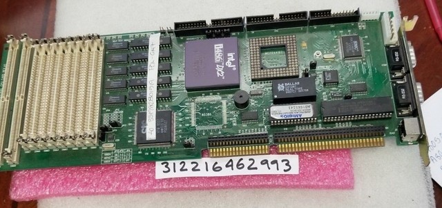

Reply 17 of 31, by Caluser2000
lolo799 wrote on 2021-07-01, 19:38:
The kind of cards you think of for personal systems did exist for a few PowerMac in NuBus or PCI format, Sun workstations had PCI addons cards too with emulated storage iirc and in some measure for the Acorn RiscPC (only as a 486 or 5x86 CPU add-on card, audio and video were emulated).
I have a different kind of card for PC but it's like having a complete PC in your machine with its own inputs and outputs, including a 2.5" IDE hdd.
You could give really old versions of VirtualPC or VMware a try.
No. RiscPC x86 co-processor cards use the actual hardware of the RiscPC mobo for video and sound output. As well as keyboard and mouse input.
