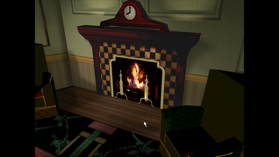

Tex Murphy: Overseer is kinda hard to run on modern system, of course dgvoodoo helps (with cursor flickers and maybe some other minor quirks), but i have strange problem - Animated Textures options always resets and only working if you enable it (every time) in main menu and then load save files..Is this game problem or dgvoodoo's? How does it behave on original hardware of its time?
Example of animated texture - this fireplace

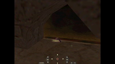

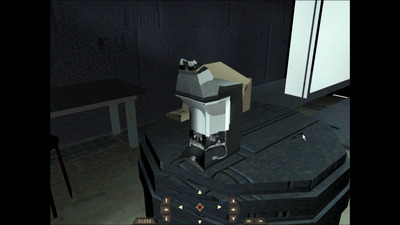

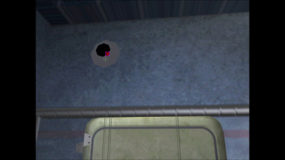

Also alpha transparency problems with animated textures in Tex Murphy: Overseer
