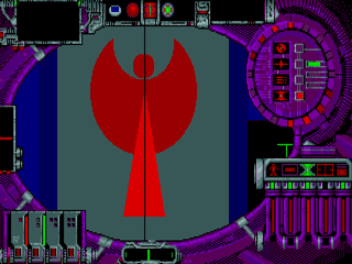

I've been playing Cybercon III over the years and I was wondering if yall might help identify what is happening. Cybercon III is a first person 3d labyrinth type game from 1992. It seems to update frames by sliding each picture over the last like a stack of cards. There is very obvious tearing when turning left and right. I've tried running this game in every build of Dosbox with every setting I can think of to clean up the visuals but nothing has done the trick. I even booted it up on the MiSTer FPGA AO486 core and it does the same thing. The game was also programmed for the Amiga and Atari ST and those versions don't have the tearing.

Cybercon III updates the screen without regard for vertical retrace, hence the tearing. The game's main loop drives the frequency of screen updates, so system speed (cycles in DOSBox) can influence the appearance of the tearing. You can see the effect of system speed even in the title screen with the rotating robot, where the rotation is slower or faster.
I made a loader program that waits for retrace at the beginning of each screen update, which significantly reduces tearing. However, it is experimental because externally manipulating framerate could cause issues, although I haven't noticed any. Waiting for retrace also makes the game run at a reasonable speed on a faster system, so increasing cycles in DOSBox to 7,000 or so should work okay; but too many cycles seems to make the game overreact to control input.
Extract the attached program in the installation directory and run it to start the game; any command line parameters will be passed along (e.g. "CC3WFR A" will run the game with AdLib sound).

That seems a rather low amount of cycles for a game released in 1992... In any case, the game code that updates the screen is doing more than a block move from memory to the screen buffer, and tearing can still happen if cycles are low.
What is needed for your purpose, I think, is to slow the game down while keeping cycles high enough to update the screen quickly. To that end, I modified the previous loader to wait for retrace multiple times before updating the screen, thus the game's main loop is slowed even with higher cycles.
The attached loader takes a first parameter of 1-9 for the number of retrace intervals to wait, with 1 being equivalent to how the previous loader works. For example, to wait 4 times and use AdLib sound you'd type: "CC3WFRX 4 A". Have fun experimenting and finding the number of times to wait and amount of cycles that works best for you!
