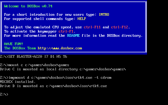

Hello, guys. I have some annoying trouble that I just can't figure solving.
I've installed Windows 3.11 on my DosBox and everything runs fine.
I've mounted cd image (*.cue) of the game and installed it without any trouble, but when I run the game it still doesn't recognize the disk.
Here are some screenshots of my mount options, proof that Win3.11 does see the CD, and the error that a game itself shows me on startup.
What am I doing wrong? I've tried mounting the image virtually and mounting the virtual cd - still the same thing.
Would appreciate any help in the matter.

The game installs a README.WRI file that has information about the error message you are encountering. The most likely cause is the "[MCI] CD Audio" driver is not installed in Windows 3, which is needed by some games to play audio tracks. The driver can be added through the Drivers dialog in the Control Panel.
Reply 2 of 2, by Boris Bezdar
Worked like a charm!
Thank you greatly!
