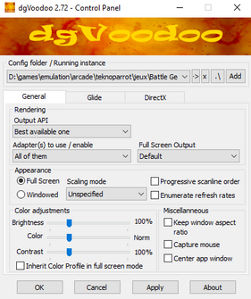

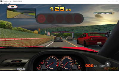

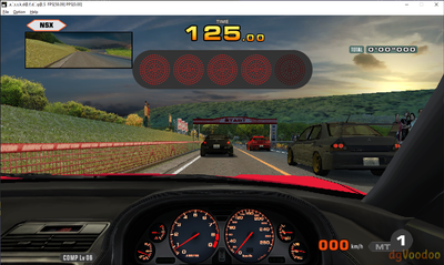

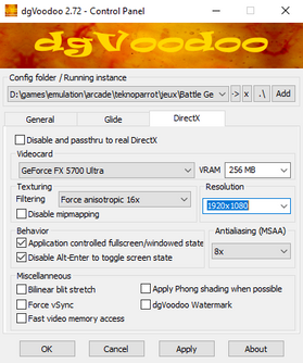

Hi,
I use DgVoodoo 2.72 to play Battle Gear 4 with Teknoparrot. The graphic improvement is amazing and I am very grateful for it.
I have a problem though: the radar showing the location of the other cars is not displayed.
The problem exists even if the resolution is unforced.
Is there a solution?

Hi,
Finally I figured out how to run this game. I recommend the latest dgVoodoo version (2.75.1). Set output API to D3D12 in the dgVoodoo config. With D3D11 (which is the default) it indeed has rendering glitches, I'll try to fix them.
Also, use the 'GF 5700 Ultra' virtual card otherwise this game seems to have the same rendering issue as an other racing game... (I forgot the name).
