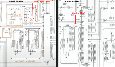

So the story goes like this : my friend picked up a Roland RA-50 and we've been thinking about modding it .
In theory would it be possible to "upgrade" it to a CM32L by adding in the PCM rom?
Or am I barking up the wrong tree?
Looking at the schematics it seems like the extra PCM chip is just piggybacked to the original pcm rom
and then both roms are linked to a glue logic chip which is then in turn linked to a pin on the LA synthesizer.
Its probably more complicated than that but I figured what the heck might as well ask.

Reply 3 of 20, by snufkin
I may have had too much beer, but it might be possible to piggy back the ROMs on top of each other, but lift pin 22 (!CE) on the top one, and connect it via an inverter (something like this: https://www.farnell.com/datasheets/158131.pdf ) with an input from pin 22 on the lower one. Pretty sure that's what the circuit diagram you posted at the start is doing (inverting inputs of an AND gate tied together makes it work like a NOT gate), making the RA19 output from the LA32 (pin 59) act as a select switch between the two ROMs.
But I've never tried doing this, so it might be a bad idea.
Reply 5 of 20, by Tiido
You also need the CPU program ROM of CM32L to actually have the extra sounds usable, the ROM already there will not know anything about the extra sounds.
You can also use a 27C801 or some other 1MByte EPROM and a wire from A19 to the EPROM A19 to get the full sample set without needing to split stuff up between existing and newly added ROM.

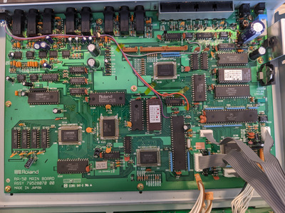

Reply 6 of 20, by RichB93
Ah 0kay- I assumed it was the same CM32L ROM already in the RA-50 as it is labelled as such.
I'm still a bit lost as to what needs to be done (electronics isn't my strong suit!)
Replace CM-32L ROM on board with 'actual' CM-32L ROM
Flash CM-32L PCM ROM onto 27C801 chip.
Piggyback burned PCM ROM chip on top of TC534000P-7476 chip, lifting pin A19 and connect this to pin 59 of the LA32 chip?
1.92 MiB
556 views
I attach a picture of the RA-50 board as I can update it as I can annotate it for others once we figure it out 😀
EDIT: I'm an idiot and just saw snufkin's comment above *facepalm*. So you'd also need an 74HC02 to invert A19 so it's not selected at the same time as the original ROM?

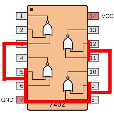

So, I gave this a go using the piggybacked chip method, but sadly to no success.
Got a M27C4001 PROM and burned the upper half of the CM32L PCM ROM to it.
Got a SN74HC02N and wired it as follows:
30.97 KiB
445 views
Pin 2 of the SN74HC02N was soldered to the CE line on the original ROM, and pin 1 to the CE pin on the new ROM.
Powered on and no magic smoke. Tested standard LA voices and they were OK.
Tested channel 10 and played the upper notes, which I believe is where the extra CM32L sound effects notes are located. But no sound.
Any ideas? Have I made any schoolboy errors? I assume that pulling pin 3 to low was correct, as otherwise I'd probably get voice corruption if pulling it high and it being active as the same time as the original chip.
Admittedly the chip was piggybacked without soldering, but all pins had a connection.
Maybe there's another connection needed somewhere to 'tell' the operating ROM that both PCM ROMs are present?
