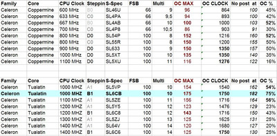

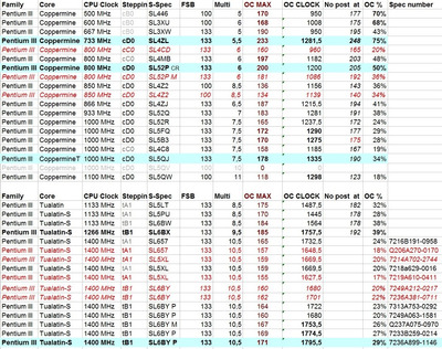

The comparison results:
As you can see the best Coppermines for overclockig are cD0 ones.
Let’s disscuss the most interesting ones:
PENTIUM III - COPPERMINE CORE!
PIII Coppermine 850 MHz - SL4Z2 (cD0)
This one didn’t overclocked as I planned. The best one gives me 136 FPS but that's enough to go from 850 MHz (100 MHz) to 1133 MHz (133 FSB). It makes a good option for old BX boards that do not support Tualatins.
PIII Copperine-T 1000 MHZ - SL5QJ (cD0)
One of the best out of the 1 GHz family. This is not a regular Coppermine but a CoppermineT. The maxium stable FSB was 178 MHz! That gave me CPU CLOCK = 1335MHz! Pretty close to 1,4 GHz 😉 Other cD0 from that family were also good:
SL5B3 – 170 MHz
SL5FQ – 172 MHz
https://u.cubeupload.com/roksana/166FSBSL5FQiSL5B3.jpg
All three of them exceeded 166 MHz so I am satisfied 😉
The one I do not recommend from the 1 GHz family is SL52R, which i my case overclocked to 165 only.
Please also notice that PIII Coppermine SL4C8 (cC0) is not a good overclocker (158 FSB MAX)
PIII Coppermine 733 MHz - SL4ZL (cD0)
Now this is the one that surprised me the most 😁
The first CPU that I got running at 200 MHz was SL52p (PIII 800 cD0). I was happy to reach that level, but I wanted more 😉 So I bought one with the same stepping but a lower multiplier (5,5x) hoping to get a little bit more than 200 MHz. What I got was a total shock 😁 235 MHz Eventually!!! At first it was 233MHz, but That then I swiched to a different ABIT ST6 board and the result improved. The CPU voltage was only 1,85v! That is 75% OC!!!
At the default voltage it can stably operate at 220 MHz 😉
CELERON - COPPERMINE CORE!
The whole CELERON COPPERMINE family disappointed me a lot. Maybe I just wasn't lucky and haven’t come up with the right batch, but out of 10 different CPUs of that type only 3 exceeded 150 MHz ;( none of them reached even close to 166 MHz. Perhaps someone can suggest which S-Spec is the best? SL54P (Celeron 800 MHz, D0) was the best one so far with 152 MHz stable FSB.
CELERON - TUALATIN CORE
I was much luckier with Tualatin Celerons but it required some skills to achieve my goal 😜 At first ,the results were far from satisfactory.... The best of celerons: 1300 and 1400 MHz were really, really bad(130 wasn't possible) even with the newer B1 stepping. Initially,the best result I got was 156 FSB on some regular Celeron 1100 MHz, but that was A1 stepping. I knew I had to find B1 with as small multiplier as possible, so I finally came across a SL6CB (those B1 seems much less common nowadays)
Celeron Tualatin 1000 MHZ - SL6CB (B1)
At last I have found a Celeron Tualatin that works properly at 166 FSB and even much more 😉
The 1750-1800 MHz seems like the regular limit for the Tualatin core. To get 1800 MHz and more you need professional cooling and volt-mods.
PENTIUM III - TUALATIN CORE
From the whole PIII Tualatin Core family I only used the 1400 MHz ones for the most of my life. There was no purpose for me to own anything slower than 1,4 MHz until I started overclocking.
PIII Tualatin 1400 MHZ - SL6BY (tB1)
In the begging I had like 7 pieces of a PIII 1,4 GHz CPUs (3 x SL5XL, 2x SL657 2x SL6BY). NON of them overclocked as I wanted to. The best of them all stopped at 165! 1 MHz from the point where I wanted and needed to be 😜 finally I decided to buy 5 more of those SL6BY for a ridiculously stupid price... and 3 of them exceeded 166 MHz 😉
Now the best one works at 171 MHz!
When it comes to other cpus from that family I was hoping to get close to 200 MHz with SL6BW, but I think I got a bad batch – the final result was only 184 MHz,
Even the faster one (SL6BX) got a higher FSB:
b6ScjZF
    360.99 KiB
    6552 views
    175.15 KiB
    6552 views

I've not checked all your math, but for the SL446, I make 5 x 170 = 850, not 950 😀
