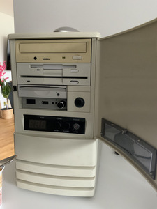

maxtherabbit wrote on 2021-10-13, 16:08:
cyberluke wrote on 2021-10-13, 14:05:
I think PC Chips were quite good.
PC Chips not good? I was thinking it is sought after. Anyway I did not know there is 386 with 72-pin RAM, I might look for that. Thank you very much guys!
Im attaching picture of my current 386 build. My first computer was 486. It took me one year to collect all parts, including the case. I got the board by accident in bigger auction and first I hate it because I was looking for 486 and description was wrong. But then I found this machine plays Ducktales (and Gunboat) correctly which makes it very playable. Classsic tweaks include XT-IDE on 3com and SD card 32gb with multiple partitions to experiment with various OSes and System Commander supports it. The zip drive is 750mb acquired of USA E-Bay. I want have retro machine, but push it to up to date as much as possible. I even got industrial ISA card with USB, which allows flash memory and also additional bios rom from WCH.cn ...Im neeerd!
    1.79 MiB
    575 views
    386DX with floppies
Reply 21 of 27, by Deksor
Nice case ! I love this design
Also yes PCChips is not reputable at all. Though they can still make a nice retro PC. Just be aware that they were scammers that tended to lie on stuff like cache and use really low quality components (thin PCB and cheap connectors).
The cache issues can be fixed on most (all ?) of their boards so I wouldn't complain too much unless you have a better motherboard. But it's not worth seeking for one if your PCChips works for your needs.
People talk a lot about them because of their quirks and also because their price at the time made them quite popular meaning there are still many around today 😀
