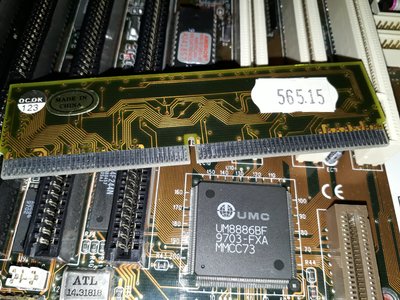

Hello,

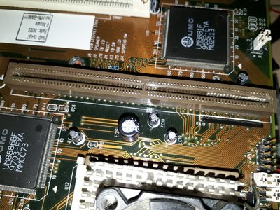

I recently purchased a PC Chips M919 on eBay. It arrived yesterday and thankfully it posted right away. It works and is stable and all. There is just one problem. It does not use any of its available L2 cache. At first I tested with my Cyrix 5x86 (which I suspect is a little broken, I think I inserted it the wrong way around in the socket when I was a lot younger anyway) and on POST it only tells me that 64k of cache are detected. I switched to an AMD DX4 NVT8 and now it tells me on POST that 256K cache are detected. All good so far. Problem is neither cachechk nor speedsys detect any L2 cache. I'm baffled on how the board can detect the cache on post but than just not use it. All 9 chips to get warm, so there is at least something happening. If attached some photos of the board, the module and the socket. Dont know if they are good enough, I can try again with my DSLR if necessary. The socket does look a little wierd but I don't know if that could be the problem and I'm not sure on how I could “fix” it.
So if somebody has any ideas or input, please let me know 😀
A little off topic: How hard and expensive would it be to produce new cache modules with some sockets on it (because it would be nice to have another one of those to test with)? There probably wouldn't be a high demand but the prices people ask for this module on eBay is and I can't imagine it would be to costly to produce given how small it is and how little components are used.

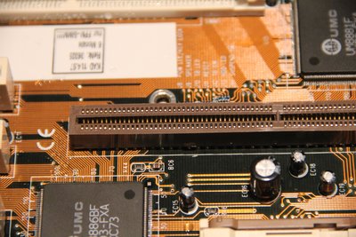

PCChips mobo will display that cache is present even when there's none. That white stuff in the COAST slot looks suspicious
Yeah as I said not really sure on how to clean it really, its so narrow. Will give it a try somehow.

Yes that slot does look pretty sketchy.

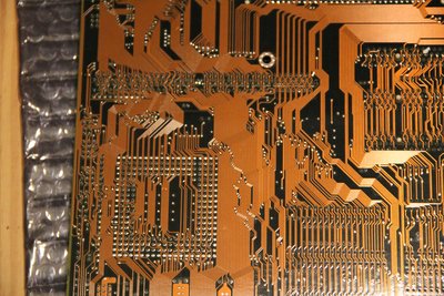

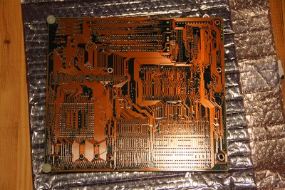

Also, could you post a picture of the bottom of the motherboard? From only the one angle that's visible in the pictures above, I noticed there isn't a single trace connected to the pins on visible side of the slot. While its possible they're ALL routed on the bottom of the board or come at the pins from the other side of the socket, those possibilities seem unlikely to me.

Well I just cleaned the slot, but I just don't have another M919 or cache module to test with. And I don't see another one on ebay for that matter even if I wanted so spent another pretty penny on it.

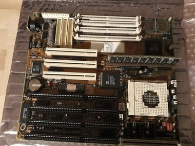

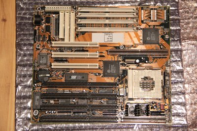

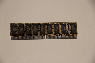

Here are some more pictures with the DSLR and the best lighting i can create without using the cameras light which makes everything so shiny.

The credit card thing is actually a really good idea haven’t thought about that before. Just cleaned the slot half an hour before you posted that.. I just a screwdriver and some paper tissue and isoprophyl alcohol (bad idea, paper stuck in the slot as I kinda expected) and rinsed everything of with the shower head. That's why the board is still wet in the pictures.

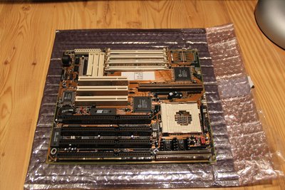

Reply 13 of 20, by Eleanor1967
Something philosophical.. Tell me if I shell retry a picutre, autofocus on that lens is quite hit or miss

Wish I could offer some help. The board and contacts on both the slot and coast module look virtually perfect as far as the eye can tell with these pictures. Hopefully it works once it's done drying.
Is this a proprietary type coast module? I used to have a few early Pentium boards that took very similar looking modules of 256-512k. No idea how hard that stuff is to come by these days. If you need to find a module specific to the m919 then man this really sucks =\
I see I can get some HM62H256AJ-15 modules on ebay but they don't come cheap. It could be a faulty memory module, if you're brave enough to spend money and take the old iron to it..
edit: I don't understand why they used the coast module when those chips look like regular dip 28 sram chips, just like every other 486 board would use. I couldn't imagine the big socket and extra pcb saving any money?

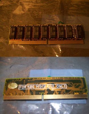

Reply 17 of 20, by chrismeyer6
427.38 KiB
1573 views
I just found a picture of the module not the greatest quality though.
