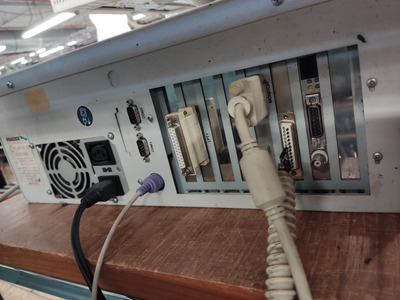

I have taken a photo of the back of the original old pc which is working:
1.23 MiB
632 views
GPL-2.0-or-later

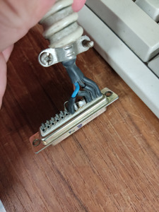

The cable itself:
1.16 MiB
632 views
GPL-2.0-or-later
I have checked the bios settings on the old PC (see photo above) and it should be the COM3.
I have a newer PC with RS232 port (Db9) I have bought an adapter to change DB25 to DB9 and plugged in the PLC, but it's not communitaces with it.
I am struggleing with it for about 3 weeks my only idea is maybe it's not a general DB25 cable (see photo) that's why maybe the adapter not works.

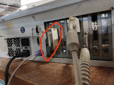

+1 Strange thing:
1.14 MiB
606 views
GPL-2.0-or-later
If I plug out the red marked dongle from the old PC then reboot it the software starts, the communication with the PLC seems working but the software is unusable, very slow. When I press down arrow I must wait about 3 seconds to go down the cursor, some functions never loads.
Plug the dongle back then reboot, everything is fast.
This dongle must have some magic in it.
Do you have any idea what should I do/check to get it working on the new PC with dosbox?

The dongle may be a copy protection device without which the software does not work properly. In that case, on the new PC you would have to either have two serial ports, one for the dongle and one for the PLC, or you would have to reverse engineer the dongle and implement it as a software dongle in DOSBox. Or just 'crack' the software protection such that the dongle is no longer needed.

Reply 3 of 4, by weedeewee
FYI the dongle is connected to the parallel port LPT1. Not a serial port like _Rob said.

If you open up the pc and check the card you should be able to figure out if it is standard db25.
To test the communication I would attempt a more direct approach to listen the port via pyserial or something before adding an other layer of confusion.
I like the idea with trying freedos rather than emulation.
