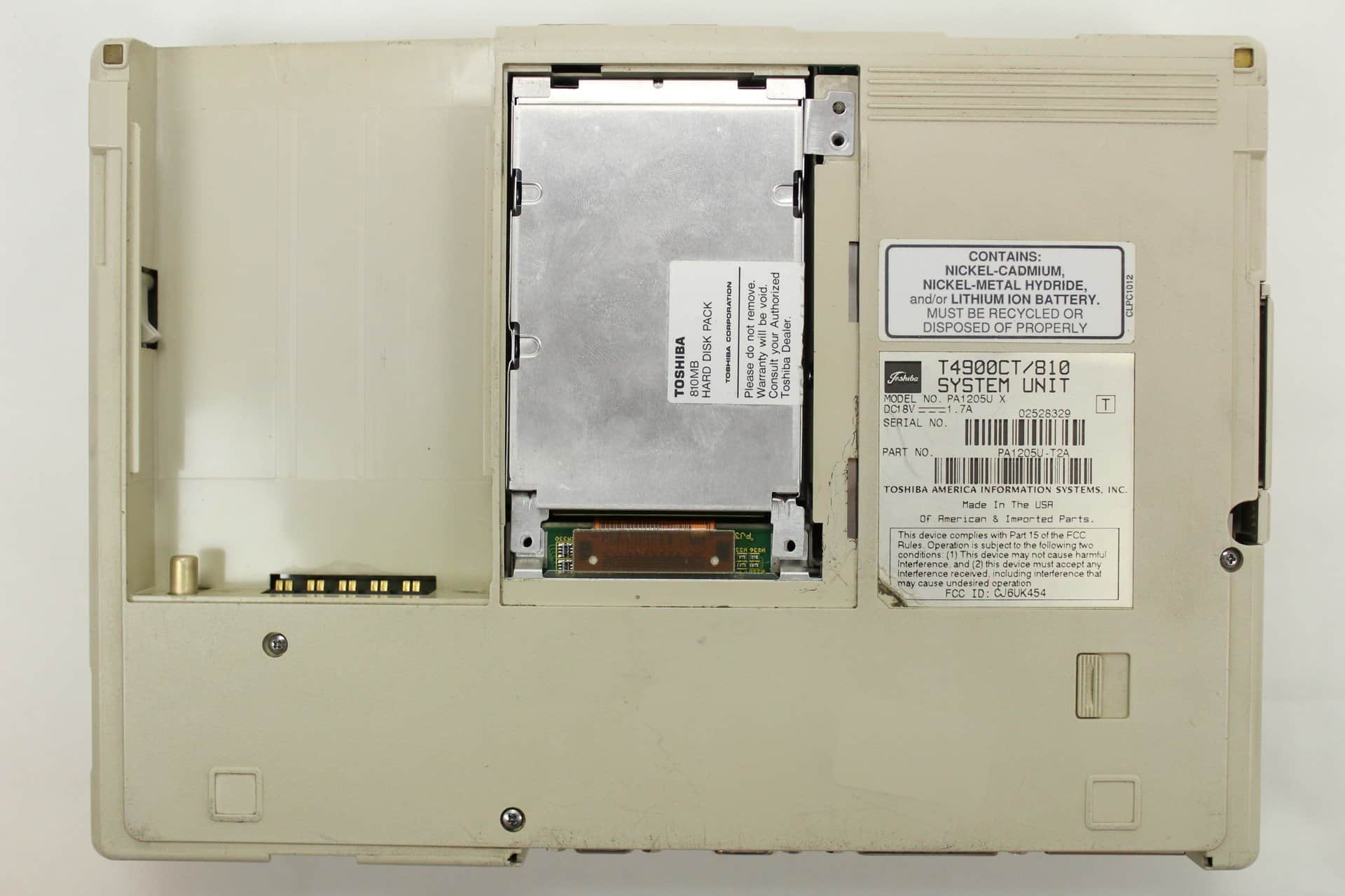

I can boot via floppy, but I need a form of storage that will fit all my games. I would like to hear suggestions for what to do about it.

Oops, sorry I forgot to mention, I have the trim cap, the photo is merely illustrative, my big problem is that I don't have the IDE interface that connects the HD to the motherboard, so I can't use a HD on it. It originally uses a traditional IDE 2.5 hd

Reply 4 of 16, by Thermalwrong
Hey there, I've also got a T4900CT, which thankfully came with a hard drive.
The connector itself is a 1mm pitch, 25-way 2 row connector, with a 1.2mm gap between the pins. The part itself seems a bit unavailable as does that type of PCB connector, but here's what it looks like:

Found from checking my connector and doing a search for "Toshiba PCB FX5HD1 P000199390 Satellite 4900CT HDD" but those pictures may fall offline soon so they're attached here.
The maintenance manual says this connector has 60 pins? Well that's wrong 🙁 so maybe we can't just check the maintenance manual - I could help with finding the pinout, but then how to sort the PCB > PCB connector? I'm thinking some 3d printed holder for 2x 1mm spaced FPC cables, going to a custom PCB with the HDD pins on it.

Reply 8 of 16, by Thermalwrong
Yeah 1mm pitch is too fine for me to solder, especially with that many connections close together. Another option though - is to buy some 1mm pitch Flat Flex Cable (ffc). You can find them if you search for 1mm ffc on thebay, they're usually quite cheap and you can get 26 wire cables quite easily. There's only one seller that sells 25 wire cables.
You can use a pair of those to solder the FFC onto the edges of the IDE connector without removing it. That then lets you run the ribbon cables further off in the hard drive and because they're aware from the connector and fixed at each end, it should be easier to solder.

Reply 10 of 16, by Thermalwrong

Reply 12 of 16, by Thermalwrong
I am now relatively sure from checking the dimensions that this is a Kyocera 5078 connector: https://www.yumpu.com/en/document/view/365434 … nector-products

Reply 14 of 16, by Thermalwrong
I found a connector that might work - this one here: 64 Way 2 Row Connector SMT 1mm Pitch AMP 120521-1 2 PIECES Z307
I bought some to play around with and the pin pitch is correct. The connector must be trimmed down to fit in a rather delicate way - each of those pins is ~1mm:

This connector is too tall to make a PCB fit onto directly, which was my original hope - but the cover does still close with this connector in place. I was going to suggest that you could get this and solder wires on for all the pins, but I've got a better idea - what if I make a PCB that solders onto the upper part of the pins facing the HD bay, then run a cheap and easily available flex cable onto pads on that PCB, like this:
7.52 KiB
No downloads
Or maybe even simpler, just make a PCB that will be soldered onto two strips of 6cm flex cable, then perhaps that could even just have a regular 44 pin IDE connector
