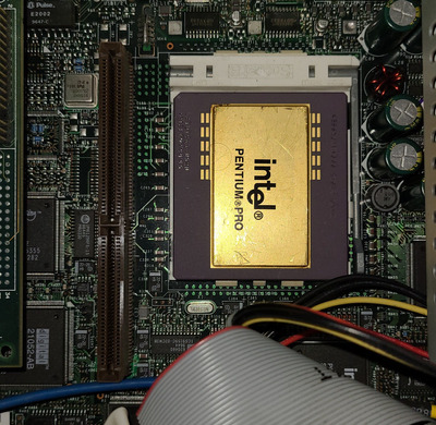

OK, so I have a Dell Optiplex GX Pro that I got off of OfferUp. I tried powering it up today and on initial boot I got the error message "Terminator/processor card not installed! System HALTED!" and it won't boot.
This system has a Pentium Pro 200 CPU. It also has a microprocessor add-in card slot to the left of the CPU, which looks very much like a Slot 1 slot.
Apparently I need to have the processor card or a terminator card installed. I don't have either.
Does anyone know where I can find either one, or what the part numbers would be?
I did find a Terminator card on eBay, a Foxconn TC7133 S1 Rev A Slot 1 Pentium II III CPU Terminator Spacer Card/Card. Here is the link to the auction if you want to take a look https://www.ebay.com/itm/274931295616?hash=it … XwAAOSwR3tcMWQD. It says it is for a Pentium II or III system, but will this work with my Pentium Pro system too?
I have attached a photo of the slot.
Thanks!

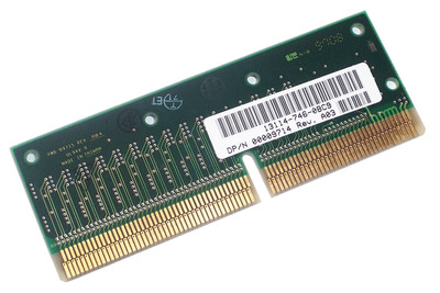

Can't find an official parts list for the GX Pro - the page is linked on Wayback but was never archived, so the following should be treated with due caution.
A Google search indicates that the terminator card is Dell P/N 00009714, and this seems the clearest pic I could find of the same (other links without pics also refer to this number as a Dell terminator card). If this is right, then there seems to be a company in the US with the refurb part in stock (at a price!!!)

Suspect the processor upgrade board will be a trickier find though - Dell being Dell, I think it was sold as an upgrade kit rather than a separate board so probably included board + processor / cooler + tool to pull the existing terminator card (referenced in one of the manuals). Google didn't help any so I don't even have any speculative P/Ns to quote.
If you check out the zipped pics at the end of this post - Re: Speed of a Retro PC - you see some shots where the upgrade is installed.

It's neither of those, or any Slot 1 terminator you're needing - their single edge connector layout is completely different from the DELL part, so I'd suggest you don't try them!!!

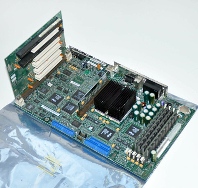

I had another quick hunt around online and managed to find some old pics of the GX Pro board out of its case, including one where the correct DELL-branded terminator card is installed. To my eye it's a match to the 9714 part above, although this time you're seeing it from the component side. Hopefully @cyclone3d may save the day.

I've attached it, and the other pics, in a ZIP for reference.
