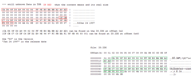

Info from installed TSR (298 bytes)
Video Card: S3 SuperVGA (Trio64) with 4 Mb
RAM DAC: S3 Trio Internal 24 bit DAC
Clock Chip: S3 Trio Internal Clock
unknown1???
CA D5 8F D3 A9 99 82 86 FF 9E B3 BA BB A2 A8 AD | ................
00 00 00 00 00 00 00 00 00 00 00 00 00 00 00 00 | ................
00 00 00 00 00 00 00 00 00 00 00 00 00 00 CF CB | ................
C7 C3 DF C6 DF D2 E9 9E 96 97 FC FB EA F1 8F 8B | ................
85 83 00 35 33 4A 61 6E 20 32 34 20 31 39 39 37 | ...53Jan 24 1997
00 00 00 00 | ....
version/license type: 0x0005
unknown2: 0x3B6A ???
enabled: 0x0000 (ON)

i still try to understand some data comming from the original UniVBE TSR (marked as unknown1??? in the above UVBCHECK output)
30.99 KiB
1942 views
unknown data (meaning and size)
i think the two missing blocks of data are someway related to the license id or something (because they are also in the IO.IDX file that gets generated by the REGISTER.EXE) - or a crypted text - any idea?

Reply 10 of 14, by llm
i've found it: the unknown bytes are the ciphered registered user and serial no
but the algorithm wasn't that hard to find/reverse 😀
for (int i = strlen(text) - 1; i >= 0; --i)
text_[i] ^= 0xff - (i << 2);
becomes "5.x Free Edition"
CF CB C7 C3 DF C6 DF D2 E9 9E 96 97 FC FB EA F1 8F 8B 85 83 00
becomes "00000-816EAD30-20020"
