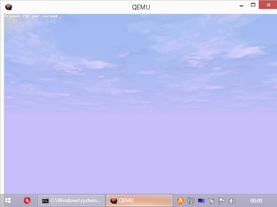

ok, it looks fake fps is actually working when minimised 😀
i got desktop set to 499Hz
so game is capped to 499fps
but when I make game minimised
and go out of minimised and immediately make a screenshot i can see over 700 fps 😀
here is screenshot

ok, now i have a susspicion here that dgvoodoo is always rendering at at least 200Hz (to reduce the screen tearing effect)
and that is the reason for the slowed down game.
cause game's fps counter always shows at least about 200fps even when dgvoodoo is set to a lower refresh rate.
while on real old computer, game's fps counter always shows 60fps.
