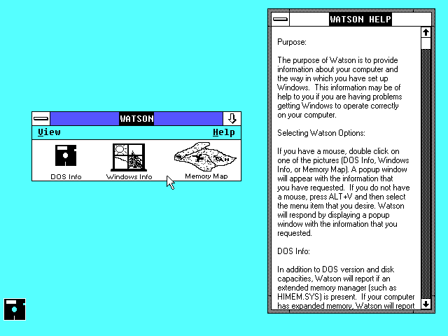

Reply 5 of 13, by Jo22
Hi there!
I've remembered an earlier thread about Windows 3.x memory managment
and found some old memory utilites for Windows 2.x, too..
Re: Viewing the Upper Memory area
Good luck! 😀

    Watson program
    memtools_win2.zip
    50.14 KiB
    45 downloads
    Freeware/Public Domain Tools Win 1.x/2.x

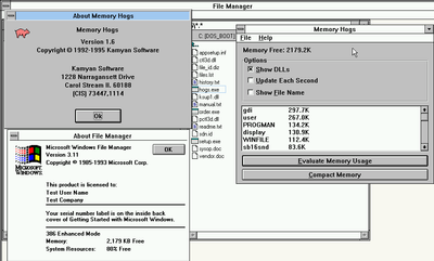

I found a shareware program called "Hogs" or "Memory Hogs" by Kamyan Software which doesn't show addresses, but shows total memory usage for each module, sorted from highest to lowest. The list of modules seems to include drivers, and also down the bottom it has fonts which take up 0.2KB each. If you don't check "Show DLLs", it won't show significant parts of Windows itself like GDI and USER and less significant parts like the fonts, just programs.

Here I gave my emulated machine 4MB of RAM. The DOS MEM command showed about 500KB of conventional memory and all 3MB of extended memory available before I started Windows, and when I added the sizes of all the modules shown by Hogs to the free memory it came out to close to 3.5MB, so I think it can see everything, or just about everything.
As I said, it's shareware. It has a registration fee of $15 and I would feel bad using it without paying since it's not hard to track down the author, but based on this post where he released the full version of a shareware game he wrote back then, it looks like he'd probably be happy to make it freeware if anyone asked: https://www.pixarra.com/pendulous.html I might ask if nobody beats me to it and I end up wanting to use it for something.

Here is a link to download Hogs: http://cd.textfiles.com/somuch/smsharew6/winutils/hogs16.zip
For anyone who is interested, I found it by browsing random shovelware CD indexes on cd.textfiles.com. I noticed that most memory-related programs seem to describe themselves as just showing the amount of memory free and used, resource usage, etc., and this was the first one whose description (in http://cd.textfiles.com/wthreepack/wthreepack … CDM/TEXT/MEMORY - yes that's a different CD, I searched the site for a newer version after reading that description) said it actually listed programs. I stopped looking after I found this one so there might be other/better ones out there.

Reply 8 of 13, by CraigAB69
doshea wrote on 2022-04-30, 02:17:
Thanks mate,
I cannot find it. I have tried searching for (Individually and a combination of:) "Memory hog", "1.6", "windows 3.1", "Shareware".
Do you have a link?
Maybe my google-fu needs work?
“Wyrd bið ful āræd. Fate is inexorable.”
Reply 9 of 13, by doshea
Oops, sorry, I meant to include the link! I've edited the post to add that to the end and also explain how I found it.
