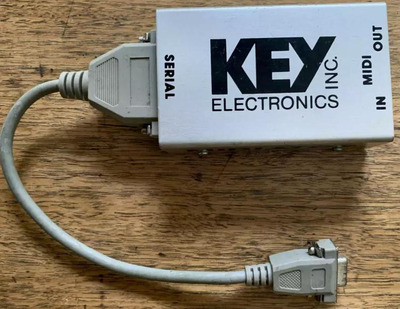

Reply 8 of 10, by liqmat
Foco wrote on 2022-01-05, 14:08:
Hello there, […]
Hello there,
I'm buying an old Pentium 133MHZ Laptop, which I intend to use on my live Chiptune shows with some MS-DOS software. It has a Soundblaster compatible card, but lacks the game port which I need for sending MIDI data to sync the computer with my other gear.
I've seeing that SoftMPU has a serial a MIDI OUT mode for the DB9 port, does it work as a MIDI IN port too? and, where I can get a DB9 to MIDI DIN cable/interface to make it work?
Thanks!
They do exist. I ran across this a few years back in near mint condition at a recycle center. Gave it to a friend who wanted them pretty bad. Maybe those photos will help in your search.
