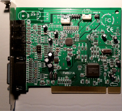

Here are my experiences with Sound Blaster emulation in DOS with some kind of generic FM801 clone I picked up in case they are useful to anyone else.
I tested this on an MSI "PM8M-V H"/"MS-7104 ver 3.0" motherboard with a VIA P4M800 + VT8237R Plus chipset. The BIOS offered no way to explicitly assign IRQs to slots, but I found that if I disabled many of the onboard devices in the BIOS settings and put the card in the slot furthest from the CPU it was assigned IRQ 5.

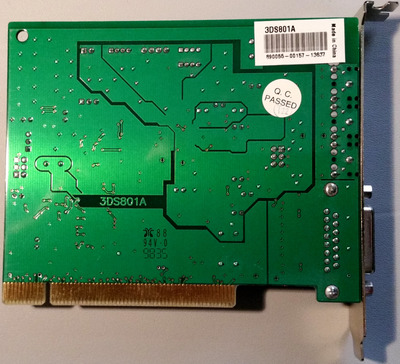

The board is labeled both "3DS801A" and "FM801A". I haven't been able to figure out who manufactured it.
906.18 KiB
2042 views
My transcription of what is on the main chip:
ForteMedia
FM0801-A1
HG73C502AFB
9825 JAPAN
I note that it has pads for a 6-pin PC_PCI header.
743.34 KiB
2042 views

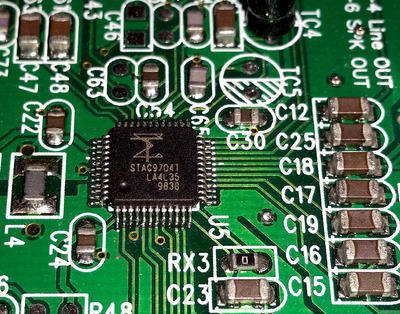

85.63 KiB
2042 views
The AC'97 codec chip which can't be identified properly from the photos above is a STAC9704T:

I can't remember, but I think it did. I'll try to test it again sometime in the next week.
It might not be relevant, but what is the AC'97 codec chip on your card? Mine is the STAC9704T, yours looks similar but it's hard to read.
