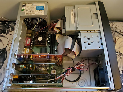

Note: This build started out as DOS/Win98 build to showcase my VIA C3 Nehemiah CPU, but I found it lacking in DOS compared to my Ezra-T. It then evolved into a bog-standard Win98 Tualatin build. Sorry about that!
In 2020, I built an Ezra-T based DOS mATX PC that has been absolutely great for playing DOS games. I wanted to expand on that and build something that would be good for both DOS and Win98. Also, thanks to Vogons, I have acquired a few parts and I needed a system I could test them on, and tinker with. After all, how could I fit in Vogons if I was happy with my build and played games on it all day?

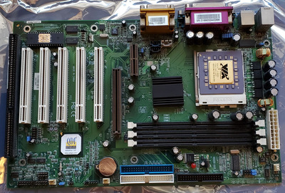

I couldn't find a suitable mATX board that supported ISA, PCI, AGP and Tualatin/Nehemiah, so I settled on an ATX board. The rest of the system was built around that:
  • Motherboard: QDI Legend Advance 10T ATX Socket370 [P6V694T/A10T]
  • Chipset: VIA PRO133T / 694T [VT82C694T + VT82C686B]

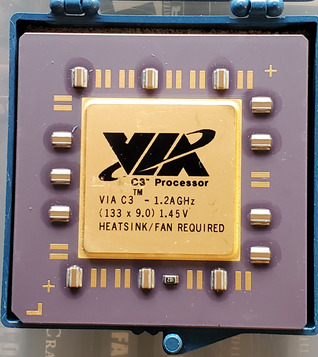

  • CPU: VIA C3 Nehemiah 1.2GHz 133X9 1.45V [C3-1.2AGHZ]

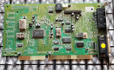

  • Audio: Sound Blaster VIBRA-16S SB16 w/ OPL3 ISA [CT2800]

Had some painful moments:
  • Breaking the metal shield off the bays in the HEC 7106BB case. But it was the only old-school case still available in my area as new.
  • Bending the retaining clip on the StarTech FAN3701U Cooler to fit the Nehemiah. Had to be done, since I could not find a Tualatin cooler online.

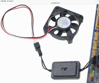

  • Mapping the non-standard USB headers to the standard 9-pin USB connector using this diagram. But I now have working front-panel USB!

  • QDI P6V694T/A10T vs MSI MS-6368:
    Was expecting the QDI to be better quality than the MSI that's in the Ezra PC, but was surprised on how bendy it was and how tight the ISA and RAM slots were. Setting the BIOS write protection jumper or BIOS setting prevented the BIOS from writing any ESCD configuration changes, causing all kinds of problems. But the most surprising and disappointing part was that the onboard SBPro2 that worked so well on the MSI (same southbridge) was so flaky on the QDI that I ended up disabling it in the BIOS. Many games played only some of the sounds, and some played no sound at all. And this is after disabling everything not needed in the BIOS.
  • C3 Nehemiah vs Ezra-T:
    The Nehemiah works well with Quake, since unlike the Ezra, the FPU does not run at half-clock. But for everything else in DOS, the Ezra is the clear winner. Many speed sensitive games need a 486DX2-66 or Pentium-90 that the Ezra is perfectly able to achieve using SetMul. The Nehemiah is better at achieving 386 and slower with SetMul, but the best it can do for 486DX2-66 is a fast 386, and the Pentium-90 is only achievable with Throttle. A fast 386 runs 486DX2-66 games like Dark Forces a bit too slowly, and Throttle causes too much stutter in Pentium-90 games like Magic Carpet. The Nehemiah should be a lot more useful in Win98.

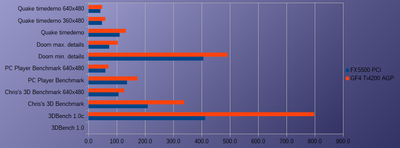

  • GF4 Ti4200 AGP vs FX5500 PCI:
    Both cards are significantly faster than the S3 ViRGE GX in the Ezra PC, with the GF4 Ti4200 being the faster of the two. Both have pretty good compatibility in DOS as well. I got them both for fairly cheap (around $20 each), and the FX5500 was supposed to have been an AGP! Will be interesting to compare them in Win98.
  • SB16 CT2800 vs YMF719:
    The YMF719 is a well loved card here on Vogons, and has gone up in price to around $30 in my area. On paper it sounds great: bug free MPU, genuine OPL3, SBPro2 support, Waveblaster support. But in practice, I found it too buggy: many applications and games stuttered, or crashed in DOS. I downloaded the OPL3SAX.zip from here and ran the included SETUPSA to configure it. On the other hand, the SB16 CT2800 has been pretty stable, and is actually better than any SBPro2 card for late DOS games. For example, you can only hear the opening voice clearly in Tyrian with a SB16 card. The noise floor of both cards seems pretty even as well, to my ears. The CT2800 is semi-pnp: the base address is set using jumpers on the card, and the rest is configured by simply setting the BLASTER variable and running DIAGNOSE /S. The only downside to the CT2800 is the "hanging-note" bug, that I will have to live with for now. The Audigy is what I had back in 2001, and is in the build purely for Win98.

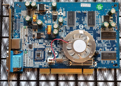

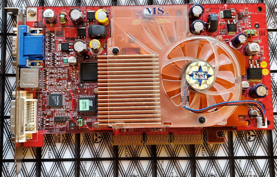

    1.15 MiB
    3260 views

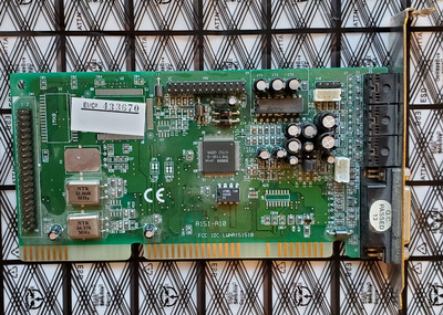

    1.29 MiB
    3260 views

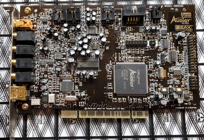

    1.22 MiB
    3260 views

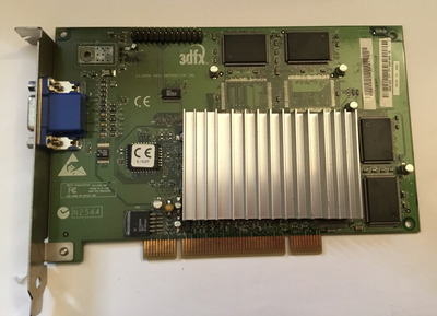

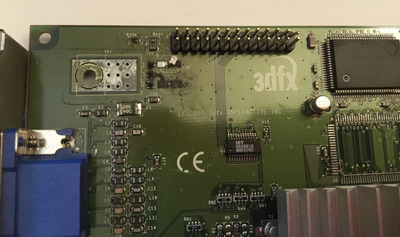

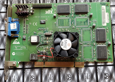

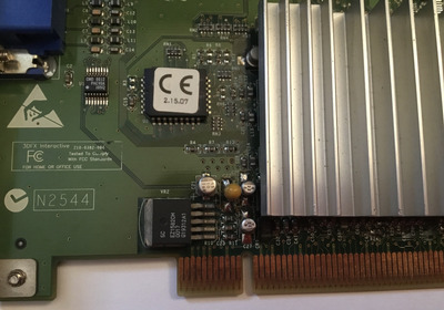

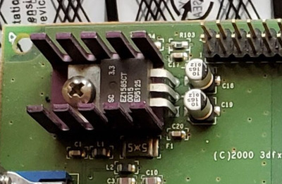

I had intended to use a Voodoo 3 2000 PCI card in this build, but I got burned (both figuratively and literally - that voltage regulator gets freaking hot!). The picture comes and goes, and this is 2D, not even 3D. I didn't realize when I bought it, that it had been modded to add a fan. I'm not sure if the mod was done because it had problems, or the mod itself is causing the problems. Either way it's been a huge (and costly!) disappointment. I'm out of my league in diagnosing and fixing issues like this. My guess is that it is overheating. The card looks physically fine, and the fan does spin. Any ideas?

Reply 8 of 82, by Joseph_Joestar
enaiel wrote on 2022-01-20, 19:50:
It's possible that the mod is to blame. However, note that the voltage regulator gets extremely hot even on stock cards.
FYI, the best way to cool a Voodoo3 PCI is to install a fan bracket below it and leave the card itself completely untouched.

Reply 10 of 82, by enaiel
Joseph_Joestar wrote on 2022-01-20, 21:41:
Would a bracket fan be able to fix the overheating issues caused by the mod?

Reply 12 of 82, by Intel486dx33

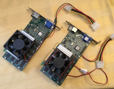

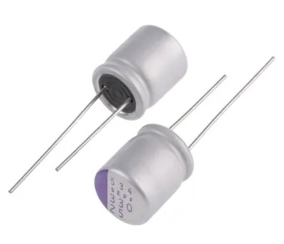

I have a couple of those PCI voodoo cards. Yes, the regulator get HOT so HOT that the capacitors next to it will start to leak and destroy the
Traces. I don’t know what the fix will be. On both of mine the capacitors leaked and destroyed the traces.
As for the fan. I would disconnect it and add a third party fan with a molex connector and speed controller.
I mounted mine with thin wire I purchased from the dollar store.

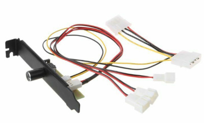

Reply 13 of 82, by Joseph_Joestar
enaiel wrote on 2022-01-21, 13:21:

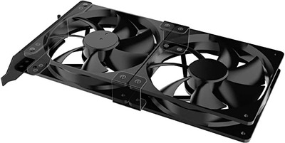

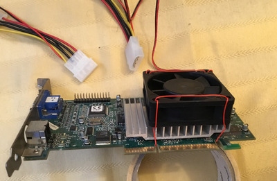

You would need to remove the existing fan and desolder the wires first. Adding a fan bracket won't do you much good unless it can blow cool air directly at the heatsink. To clarify, I'm referring to one of these things:
30.73 KiB
3014 views
You can get these brackets from Amazon and various other places. The fans are not included and you need to provide them yourself. I recommend using Noctua branded ones.
Reply 14 of 82, by Intel486dx33
The GPU chips on these Voodoo cards run VERY HOT so you definitely want to add a fan.
This is the main reason there are so few PCI voodoo cards around because they over heated and the capacitors leaked and destroyed
The traces on the PCB.
The AGP voodoo card are a little better but they too run very hot.
Both require a fan to keep the GPU chip and PCB cool.
Reply 15 of 82, by enaiel
Intel486dx33 wrote on 2022-01-21, 14:08:
Hmm, if these PCI cards are getting rare, maybe I should try to save it. Do you have a pic of your damaged cards? Do you see any damage in the pic I posted above?
Joseph_Joestar wrote on 2022-01-21, 13:56:
How do I take out the fan without damaging the GPU chip or the PCB? It looks like it is stuck with a white thermal epoxy.

Hmm, if these PCI cards are getting rare, maybe I should try to save it. Do you have a pic of your damaged cards? Do you see any […]
Check both sides of your voodoo card and see if there are any brown spots on the card. The brown spots would indicate over heated areas on the PCB. You could leave the fan on and just cut the wires that are soldered to the circuits and instead use a molex connector
To connect the fan. I am not sure if that fan is 3volt or 5volt but the molex connector has both. So you could use either.
But that fan does seem inadequate. A heatsink with a larger fan would be best.
Reply 18 of 82, by Intel486dx33
Look here. I think it is the same as yours.
I took this one apart. I still need to fix the damaged area.
See the black spots on the PCB is where the capacitor ruptured and leaked onto the PCB
Damaging the traces.
The fix:
I think the fix is to get the surface mount capacitor off the PCB. So I plan on using a capacitor with long legs instead.
This should keep the capacitor from getting hot and rupturing.
Reply 19 of 82, by Joseph_Joestar
enaiel wrote on 2022-01-21, 15:23:
On the picture that you posted, I see screws going from the fan into the heatsink. Therefore, it should be as simple as unscrewing the fan and desoldering the wires.
Unless whoever modded the card actually glued the fan to the heatsink for some reason?
