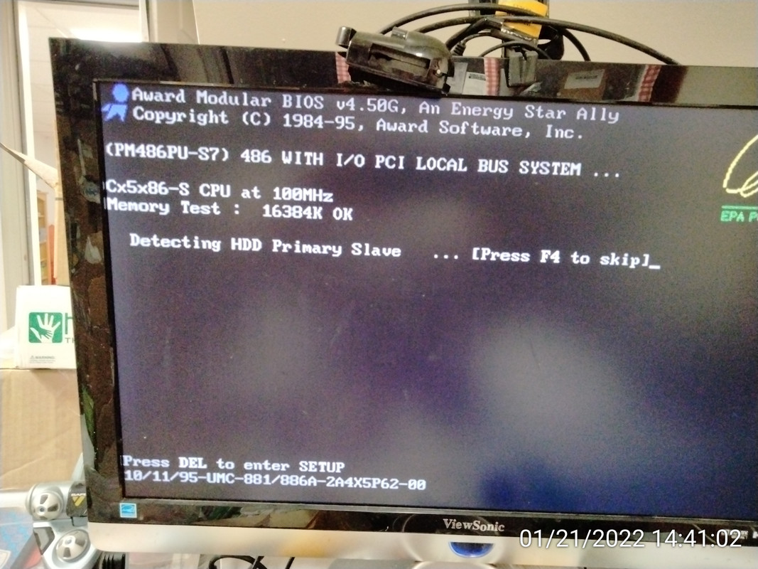

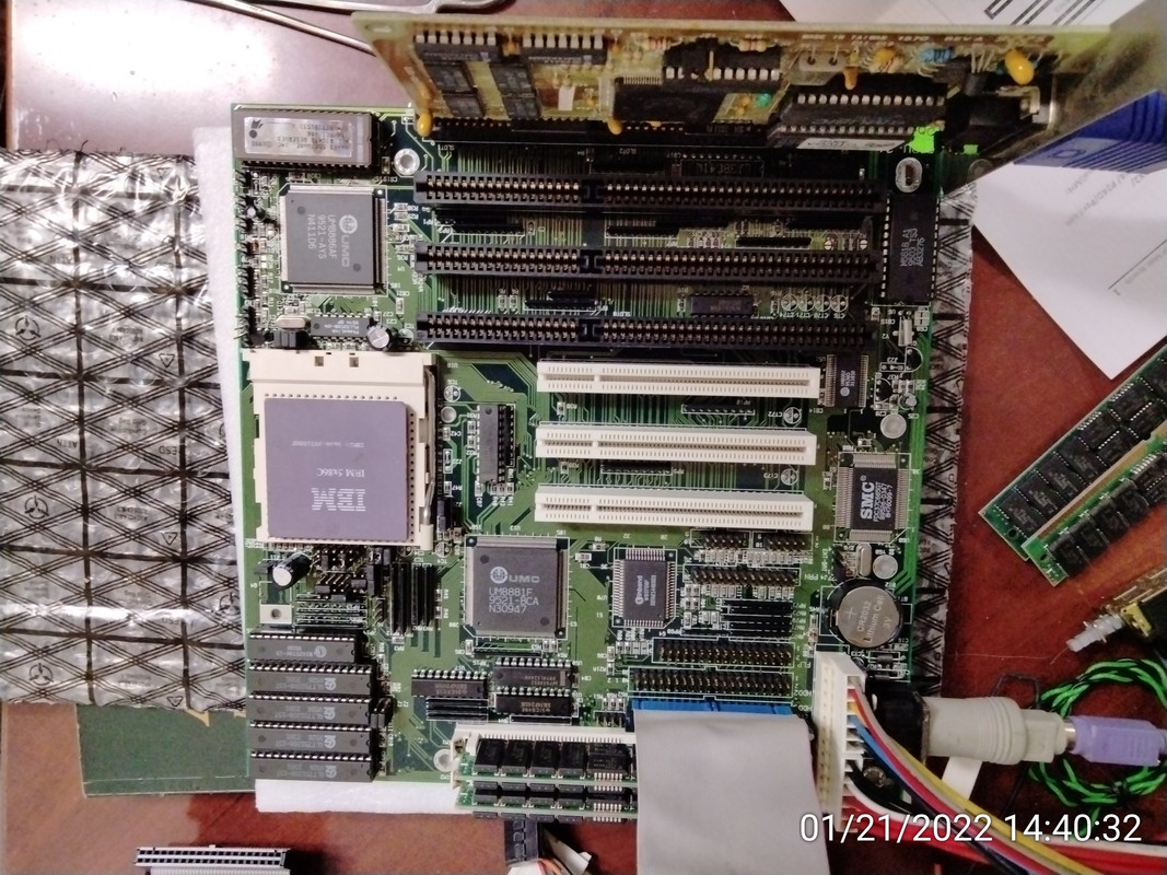

Since I had some time for retro hardware today, I decided to finally test a motherboard that I bought several weeks ago but didn't get to trying: Protech PM486PU-S4. It's documented here as well: https://www.ultimateretro.net/en/motherboards/5541

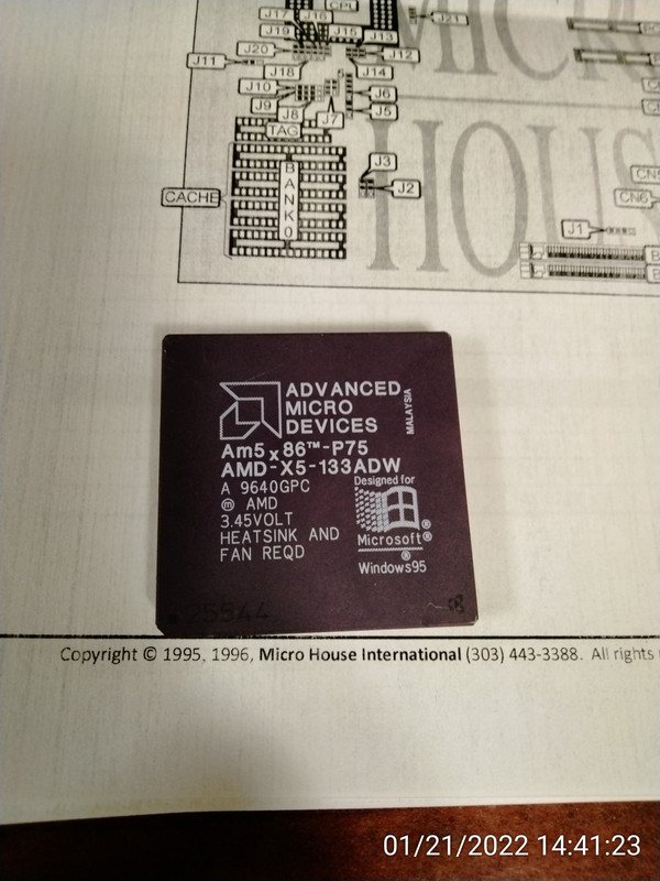

I went superficially through my CPU stack and pulled 2 which should work with it: an IBM 5x86-100 and an AMD 5x86-P75.
This motherboard has a LOT of jumpers. I found a jumper guide at https://www.ultimateretro.net/en/motherboards/5541#downloads but unfortunately that does not have settings specific for the AMD CPU. With patience, I set the jumpers as for an AMD 486DX4, expecting it to work. And of course, I checked them twice, and didn't forget to set the right FSB of 33 and correct voltage. But the motherboard didn't POST when powered up. The CPU is known good, it works in another 486 motherboard. It did get warm while I had the power on.
So I switched to the IBM/Cyrix CPU, and set the jumpers as per the CXM1 in the jumper guide. With that, the motherboard did POST, I could get into the BIOS settings and adjust date/time, other settings etc, save and reboot. Everything looked to be working fine.

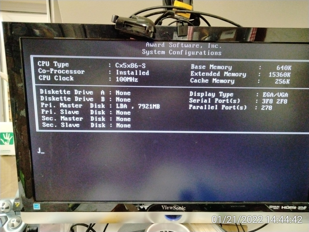

But then I attached my usual test drive (a CF card with DOS 6.22 and utilities, the same one I used to test the motherboard in the other thread A nice late socket7 motherboard: PCPartner TXB820DS 35-8333-03 ) and it does not boot. The card is detected correctly by the BIOS detection utility and set as primary drive, etc. But after POST is finished, it locks up when trying to boot. At that point the computer becomes unresponsive, the keyboard has no effect (not even ctrl-alt-del) and I have to turn the power off.
I have gone back in the BIOS and tweaked all I could think of (turned off "block mode" for IDE, turned off 32-bit mode for IDE etc) but it didn't make a difference.

Motherboard with memory, CPU, video card and IDE cable

That letter "j" was not typed by me. It appears there automatically without me touching the keyboard. At this point, it does not respond to keyboard anymore.
The CPU that did not POST

Reply 1 of 51, by stamasd
The plot thickens. I've hooked a Gotek floppy emulator, with a bootable DOS 6.22 image. It boots correctly from it. After booting, I can access drive C: and run programs from it without a problem. I've also ran a scandisk on C: and no errors found. But I still can't boot from C:. 🙁
FWIW, C: is a CF card with a 2GB DOS partition on it. It works fine in all machines I have tried it on, except for this one.

Reply 3 of 51, by stamasd
Well, last test for today. I ditched the CF card, and took a 4GB Seagate microdrive. Put that in a CF/IDE adapter and connected it to the primary IDE. Booted from floppy, partitioned the microdrive with a 2GB DOS partition, formatter it and transferred DOS to it. Set the BIOS to boot from C: again, and it still doesn't. This time instead of the "j" it shows me a string "Error!" and hangs.
I guess something must be wrong with the IDE ports on this motherboard.
So for now I can only boot from floppy, although after boot I can use drive C: normally for some reason.

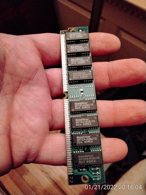

Reply 6 of 51, by pentiumspeed
Switch out the fake memory sticks. This one has non-standard chips on it made me feel this is fishy.
Use FPM 4MB or 8MB non-parity memory sticks please.

Reply 7 of 51, by stamasd
I don't understand what you mean by "fake" memory. These have been tested and work fine in many other motherboards.

Reply 8 of 51, by stamasd
But here, just to eliminate any questions of "fake" memory, I have replaced the memory modules with this. I hope you approve of it. 4M of FPM memory.
Same error.

Reply 15 of 51, by stamasd
Well I managed to have this board boot from the primary IDE channel. I had to blank a CF card by writing all zeros to it, then partition/format/install DOS, and then it booted. It did not boot if I did this without erasing it completely.
That is the good news. The bad news, the second IDE port is bad. Any drive attached to it is seen by the BIOS autodetection routine, but cannot be booted from. Moreover, after booting from floppy, the drive on the secondary IDE is not accessible. And if I attach drives to both the primary and the secondary IDE channels, it prevents it from booting even from the primary IDE with the message "hard disk failure". If I then remove the drive from the secondary IDE and leave only the one from the primary, it boots normally.
Oh well. I guess one working (and bootable) IDE port is better than none.
(oh and FWIW I reinstalled the "fake" memory sticks which work great on this board and pass all tests)

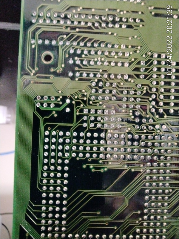

Reply 18 of 51, by stamasd
Crap. I think I won't be able to run 3.3V CPUs on this board. I did some tracings and measurements, and I think that despite there being a pad and holes for a VRM, installing the regulator chip will not work. Let me explain why.
Here are large pictures of the area, both front and back of the board.
You can see the empty spot for the regulator chip, the holes for its terminals, and below it jumper J11 which is supposed to control the CPU voltage, with position 1-2=5V, 2-3=3.3V (if LDO chip is installed).
That is the theory. However, I have measured the voltage delivered to the CPU, with either the jumper in position 1-2, 2-3, and also with no jumper. It is always 5V. Yes, with the jumper completely off the CPU still gets 5V.
I have traced electrically what goes where. Pin 3 of J11 goes to the output of the VRM. Pins 1 and 2 both go directly both to 5V from the power supply, and to the CPU. I can't trace physically the copper traces that do that because I think they're in one of the inner layers of the board, but electrically that's how they are connected.
I think the idea behind J11 was thus: pin 1 connected to 5V; pin 3 connected to the VRM output, i.e.3.3V; and pin2 to the CPU. This way, with a jumper between 1 and 2 the cpu would get 5V, and with the jumper on 2 and 3 it would get 3.3V.
However, somewhere there is a short or bridge between pins 1 and 2. This makes the CPU to permanently receive 5V, and not the VRM output voltage regardless of the position of the jumper.
I have seen other boards where this is done via a solder bridge or permanent jumper, so that in absence of a VRM chip the CPU still receives voltage- and when you install the VRM chip, you have to undo that bridge.
Except that on this board, I cannot see any such bridge. There are no 2 pads connected by a wire, nothing that looks that it could be opened up. Neither on the front nor on the back. See the close-up pictures above and try to find one, I couldn't. I actually examined a much larger portion of the board, both front and back, than is shown in the pictures. Nothing.
If I cannot undo the permanent connection between pins 1 and 2 of J11, there is no way I can use a 3.3V CPU - because in this arrangement the CPU receives its voltage directly from the 5V rail of the power supply regardless of the position of J11.
I think that for some reason, on this board they made the connection between pin 1 and pin 2 via a trace on one of the inner layers of the PCB, which is not accessible.
If anyone has any ideas on what to do, I'm open to suggestions.
Here are links to high resolution pictures:
https://postimg.cc/xkWxQ2Rj
https://postimg.cc/Ln9Mwt5C
(R55 and R57 are the resistors that set the voltage the VRM gives, the rest of the small components around the area are all capacitors)

Reply 19 of 51, by TheMobRules
Strange. Maybe one of the other jumpers currently set on the board is making that connection? You could try measuring resistance between J11 1 and 2 with all jumpers removed. If the bridge is gone, you can then set the jumpers again one by one to see which one bridges those pads.
Also, maybe some circuit is used to switch the voltage based on the VOLDET pin of the CPU (S-4), so you may want to trace that one and see where it goes.
Other than that, I don't know why they would permanently bridge those with an inner trace... sounds really stupid, but hey, stupid things were common on boards from that era!
