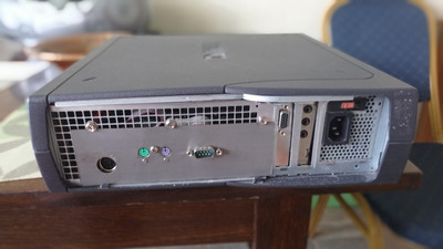

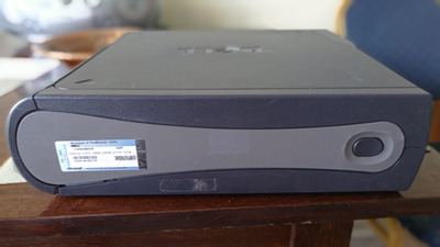

A Dell small form factor case. Originally a P4 of some kind. Small ATX PSU. Low profile floppy and DVD-RW, both use a standard plugs for motherboard. Few modificatons to the case. front switches for Turbo and DX2 50/80 speed. Overclocked/underclocked AMD 3.3v DX2 66. Asus PVI-486SP3. Trindent 9000i 512kb ISA. That crappy Sound Blaster 16 clone ALS100. Both are crap, but are so low profile, that they fit in the case. 20GB 2,5" HDD, only 8GB is available without software layer. The guts are a mess, but it is compact, and all works, and i can make game collections with DVD+R disks. By the way MSCDEX reads all the 5GB just fine if you put 8.3 file name and some directory tree limitations on the burned ISO.

Reply 1 of 5, by Cyberdyne
If you overclock the ISA bus, 40MHz FSB 1/3 fraction is 13,33MHz, the ALS100+ works fine, and Trident 9000i runs Doom just fine and with Fast Doom h13 mode it is butter smooth, in the good VESA card and DX4 levels smooth. In lower ISA speeds the Tridend will bottleneck a little.

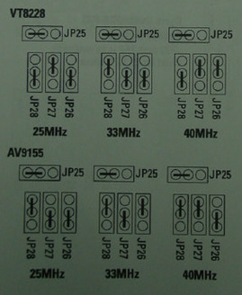

Reply 4 of 5, by Cyberdyne
Well my main problem is space, and it is just a nice hobby, to cram retro comuters in small cases. I have use a VCR case, DVD player case, few small UPS cases, uATX case. 486 cpus are X locked in my opinion. So you can not change from DX2 to DX4, but FSB easily changeable and somehow the FSB speed change in Asus PVI-486SP3 is totally hotswichable like turbo. So 25/40 fsb change is noticeable if you spin around in DooM and switch the FSB jumper.

Reply 5 of 5, by Cyberdyne
I have the AV9155 and i connected JP27 upper pins to a switch. All lower pins are only a parking position, so nothing changes, if you do not short lower pins.
