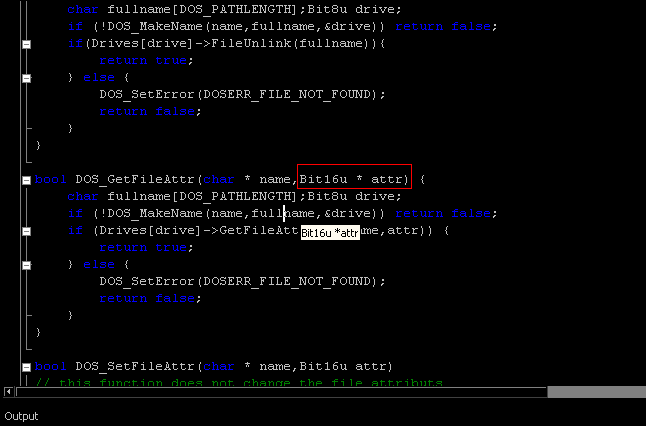

while preparing for .net 2005, I noticed a strange behavior with my .net 2003: if at a certain point of a piece of code a variable called "attr" is declared, any following variable and function will be visualized in the ide of the type of attr. Yes, this is not a big problem, but prevents the ide from using the "Go to definition" function, which I find useful.
Does anyone else with .net 2003 have this problem?
