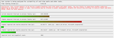

I checked a program called LatencyMon and the latency constantly gets to some ridiculously high spikes, like nearly maxing out the meter. I don't know how installing an SSD would cause this or if its just a coincidence, but I don't recall any of this before doing so. The driver causing the highest DPC latency is ndis.sys, relating to my network drivers, so I tried older and newer drivers to no avail, and even if I disable the network/WiFi drivers entirely, LatencyMon still shows crazy latency with no driver really associating with it.

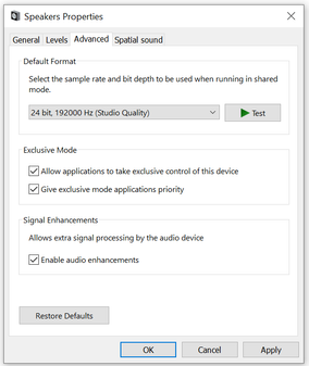

I had a similar issue with a desktop and my add-on sound card.
The issue was, windows was using a different quality/bitrate setting than what the sound card wanted. I attached a screenshot of the setting you need to check. I hate the WinBlows 10 settings, everything made much more sense in 7.
The default format needs to match your particular sound device. For my Soundblaster ZXR that was easy to find, but if you have onboard sound it might be much less intuitive. You might even have to google for a datasheet in some cases.

I looked at the datasheet and it's supposed to support up to 24bit 192khz, and Windows is already set to that. Btw, under the enhancements tab if I check disable all sound effects the audio becomes extremely tinny even though I have nothing enabled under the effects list.

I tried all those suggestions and did they work? Well...
The attachment nope.PNG is no longer available
Notice what I was saying earlier where the highest measured interrupt to process latency meter isn't matching up with the highest DPC execution time reported.
